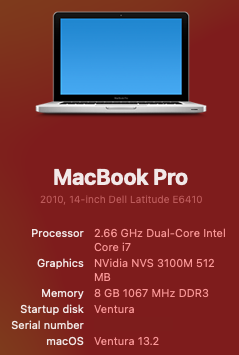

I have now upgraded my HackBookPro6,2 to Ventura 13.2 with OCLP 0.6.1. I'm impressed! Monterey is now my "production" version of macOS for my rig while I continue to tinker with Ventura. The OCLP team is doing an awesome job.
