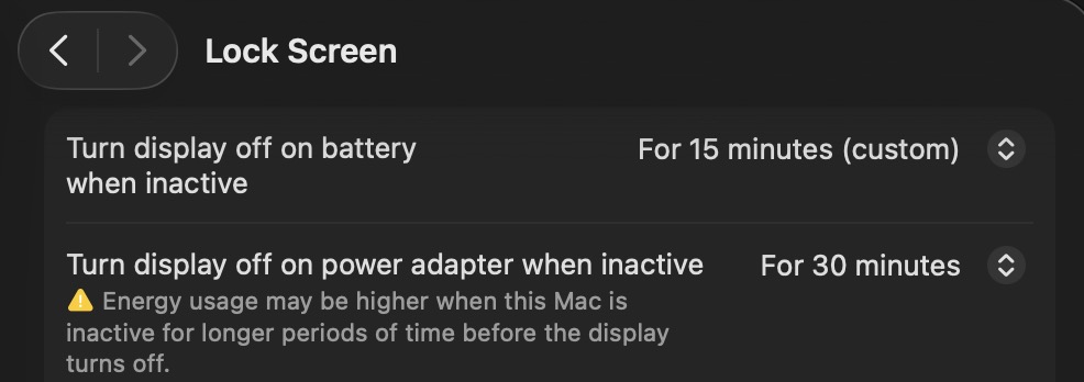

Yeah I remember this setting too - I think the closest thing now is:
Lockscreen:
Okay thank you I got the sleeping to work I guess and put the mac to sleep for 2 hours. After turning back on the mac I checked the CPU processes of the last hour (iStats menu) and saw that the CPU woke up every 5 minutes or so. Is it then actually in sleep or not? I would assume in sleep there will be no activity.
