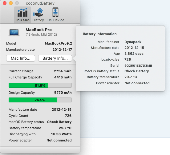

I'm also looking to replace my battery on a MBP 13 mid-2012.
If I could find the same battery that I purchased in 2015, I would do it in a heartbeat. See below. Almost 13 years old with 726 cycles and I still can manage to get 4 hours out of it. Dynapack is a great battery manufacturer from my experience.
