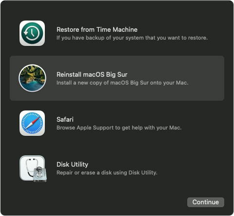

Everything worked great. I did the ⌘+R when starting the laptop and heard a faint chime before releasing the 2 keys and was greeted with the recovery menu.

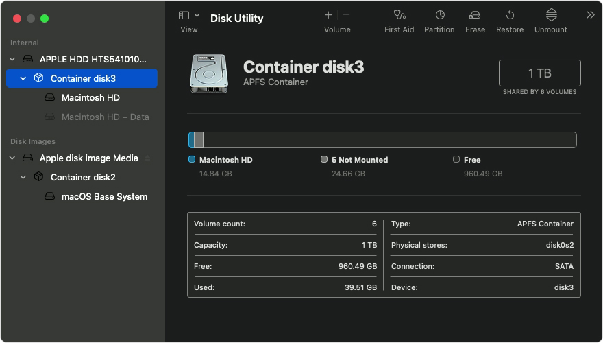

The first time coming to this menu I just did the Reinstall macOS Big Sur. Took 2 hours but everything did re-install BUT did not seem to delete my personal user and my files. So reading up more on how to wipe the HD I came across an article stating to use the Disk Utility to format the drive and remove the volumes.
I used the "-" button one each of my 2 listings under the Internal section. Deleted those just fine. Now this is where I messed up. As the article I was reading said to exit out of Disk Utility and go back to the main menu and choose to re-install. However, the screen on my tv did not show any outer edges enough for me to actually see the tool menu so I just used the mouse and clicked in the area where they were. I chose something and it shut down the laptop. I honestly have no idea what I chose... I was going for exit disk utility's but I do not think I got that.
