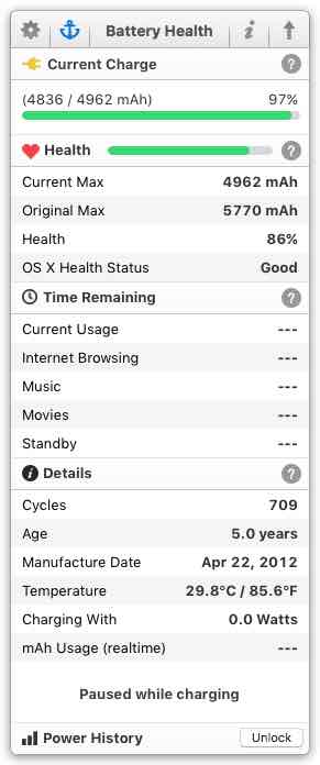

Battery Health, for what it's worth, is at 86%
battery Age: 5 years
Cycles: 709
Cycles: 709
