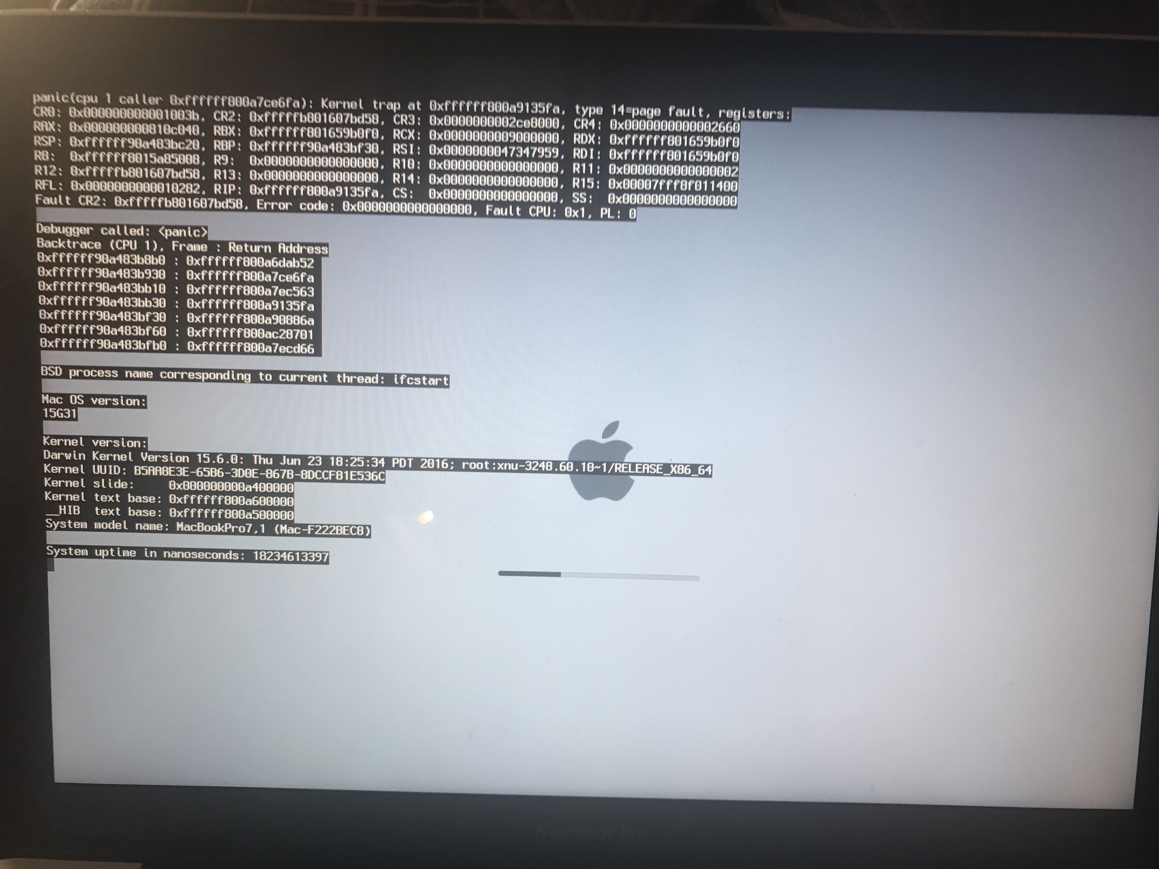

Hey everyone
Not total tech rookie here, but by no means an expert. A few days ago my macbook pro mid 2010's started crashing. Suddenly full black screen and constant beeping - I looked it up and it was probably a RAM problem..? Anyways, I couldn't get to a service yet but it started up after a few hours just fine but chrashed again, same black screen and beeping. Now it only starts up and shows the - hopefully - attached message.
What could this problem be?
I haven't altered anything in the hardware, haven't updated to Sierra OS, I'm on the newest El Captain...
Does anyone have any suggestions?
Hey everyone
Does anyone have any suggestions?View attachment 693212

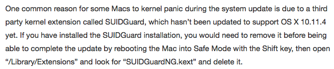

[doublepost=1490263122][/doublepost]Before this happened, did you have SUIDGuard installed on your Mac ?
I had a similar problem on my mid-2010 MacBook Pro about a year ago.
Removing SUIDGuard using the method below, cured the problem

Thanks for the tip, unfortunately it was never installed on my Mac...:/
The booting into safe mode was a torture in itself, I had to restart it twice before it worked.

Unfortunately it also crashed in safe mode.
I'll try your RAM moving method, hopefully it'll work.
Now it turns on without problem, not in safe mode, and if I don't do anything just leave it there it won't crash. But soon after I try to browse the internet or get into any program the screen goes black.
