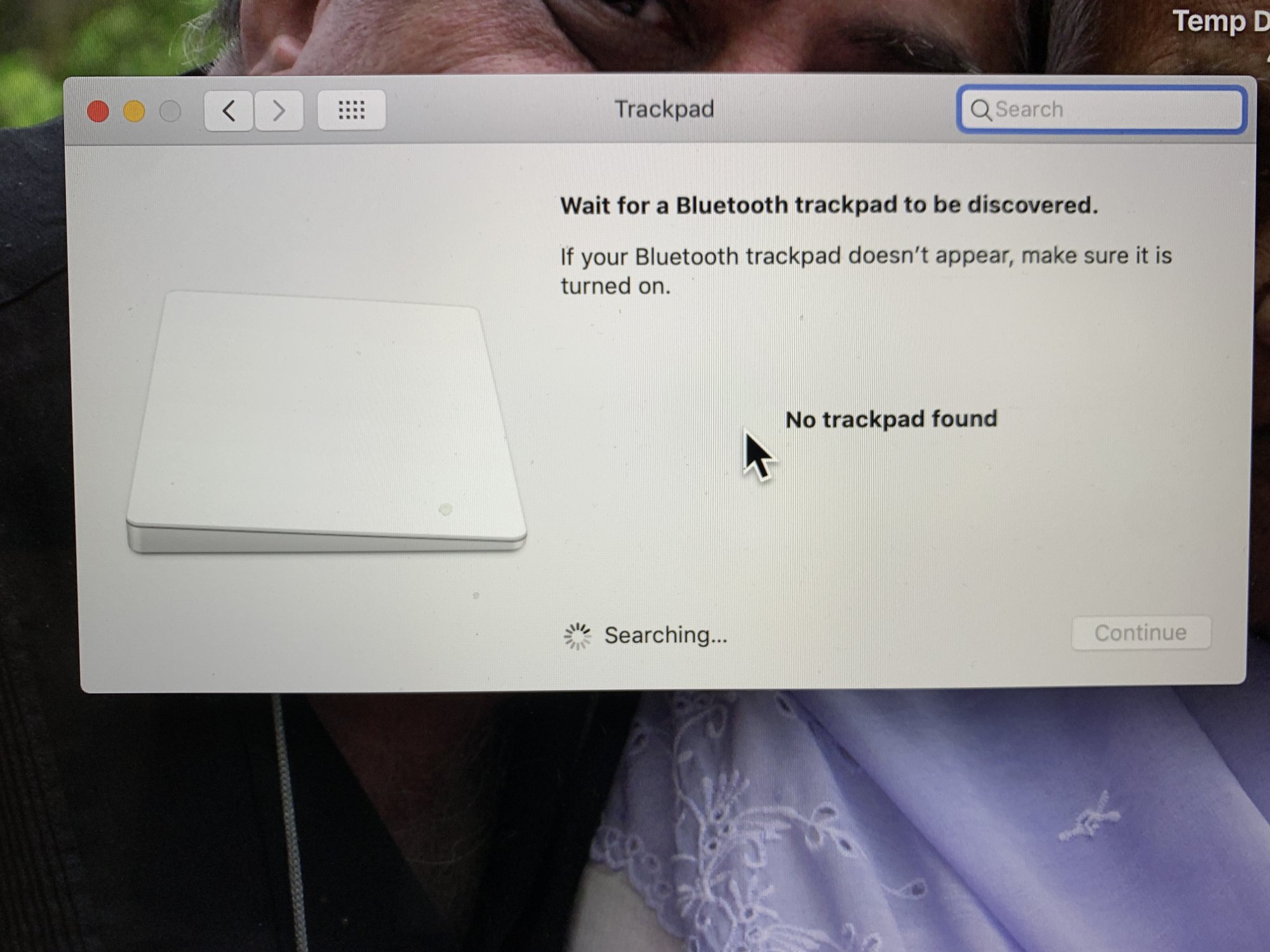

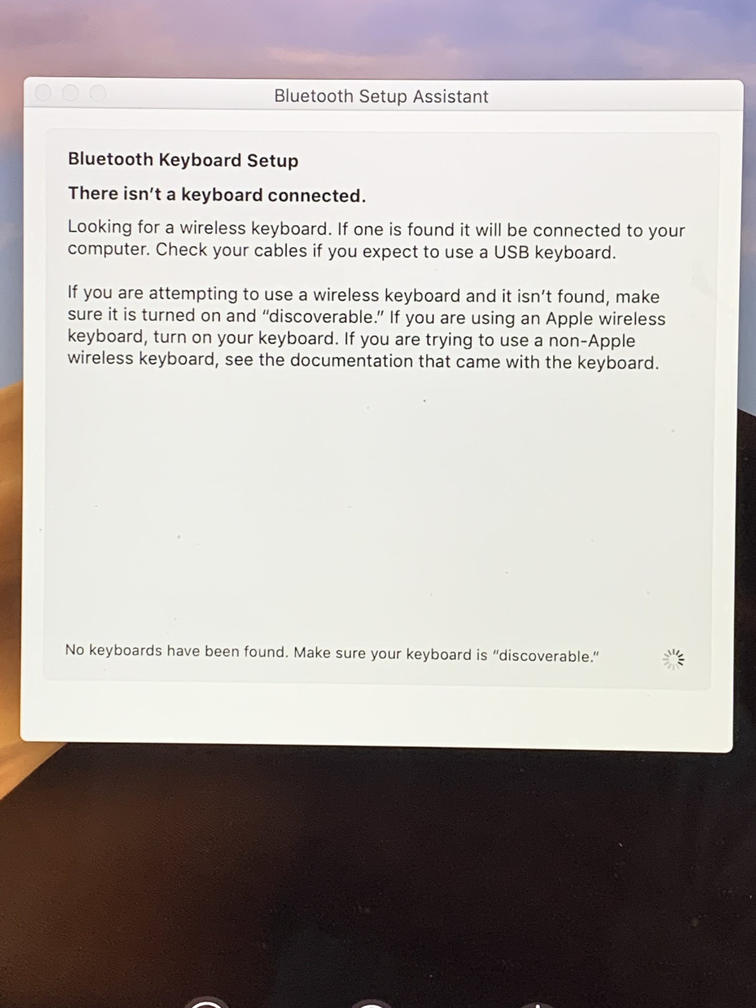

I very carefully removed the existing battery & installed the new one. Upon starting the rMBP with the new battery, I got a message stating the the Keyboard & Trackpad was not detected & neither of them responded to any input.

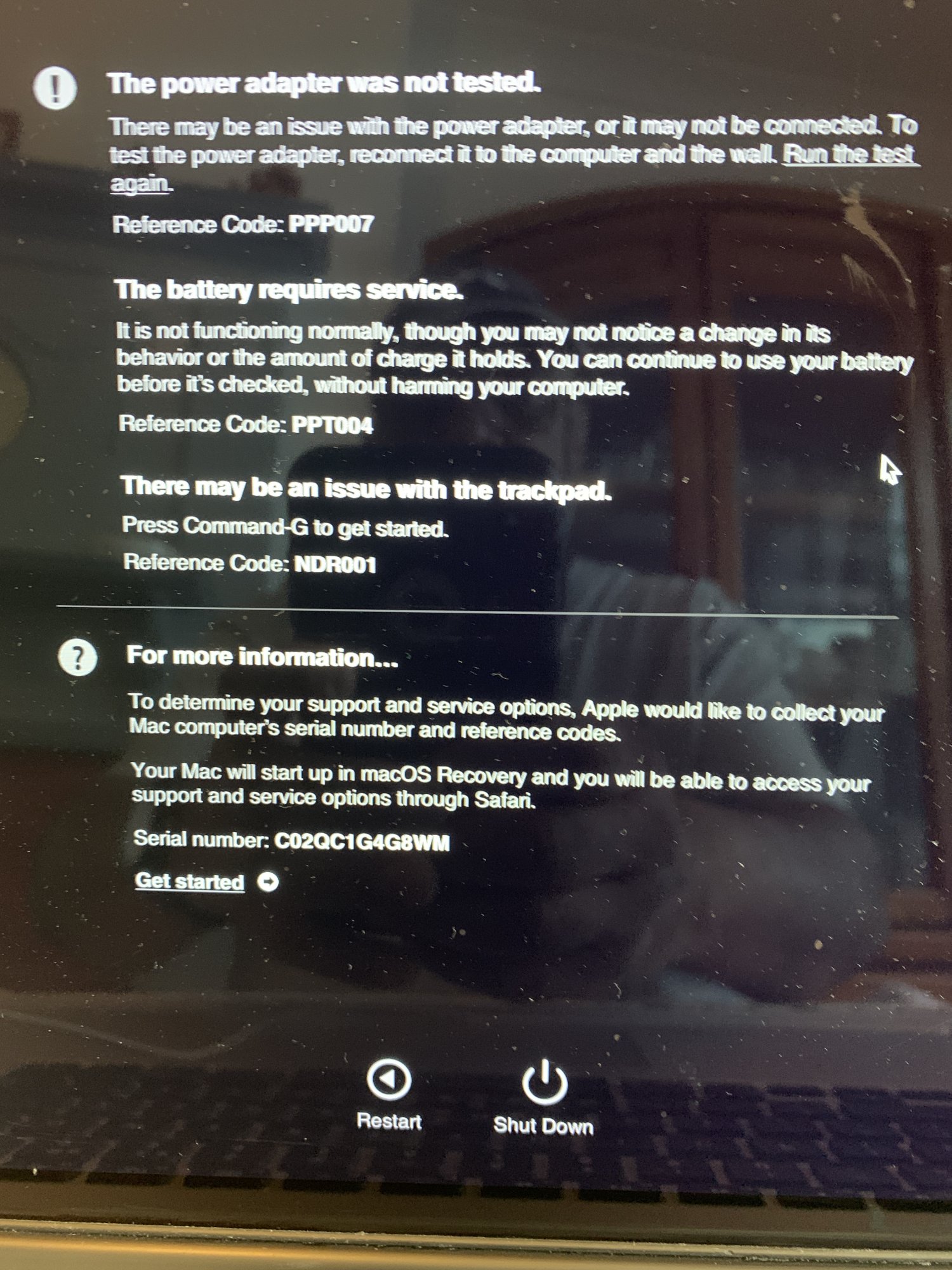

I was asked to do the Apple Diagnostics Test on the rMBP & it came with a couple of issues saying "Battery Needs Service" - code: PPT004 which I do not understand as the battery is brand new & working fine.
It also reported that there maybe an issue with the Trackpad & to press "Command-G" to get started which I did but still no response from either keyboard or trackpad? The code was: NDR001 which I looked up on Google & the results showed that is code pertains to a corrupted Trackpad but again, the Trackpad was a new one?

An update if it might help - I had hooked up an external keyboard & mouse & did a PRAM reset. Low & behold, after starting up, the stuck cursor on the screen became free & both the keyboard & trackpad responded & worked normally - even after disconnecting the external keyboard & mouse.
I then put the unit to sleep as I had to take it to another location. Upon waking it from sleep - the same issue happened again. I tried to do a PRAM reset again a few times but there was no response from the computer - it just would not start up. The Power on/off button works fine. I also tried to do an SMC Reset but again, no response at all from the computer - would not even start.
The fact that at one point, after doing a PRAM reset via an external keyboard allowed the Cursor, Trackpad & Keyboard all to become fully responsive gives me hope that this might be some sort of software/OS Glitch as I read many others also had non responsive Keyboards/Trackpads in the past simply by updating their operating systems?
