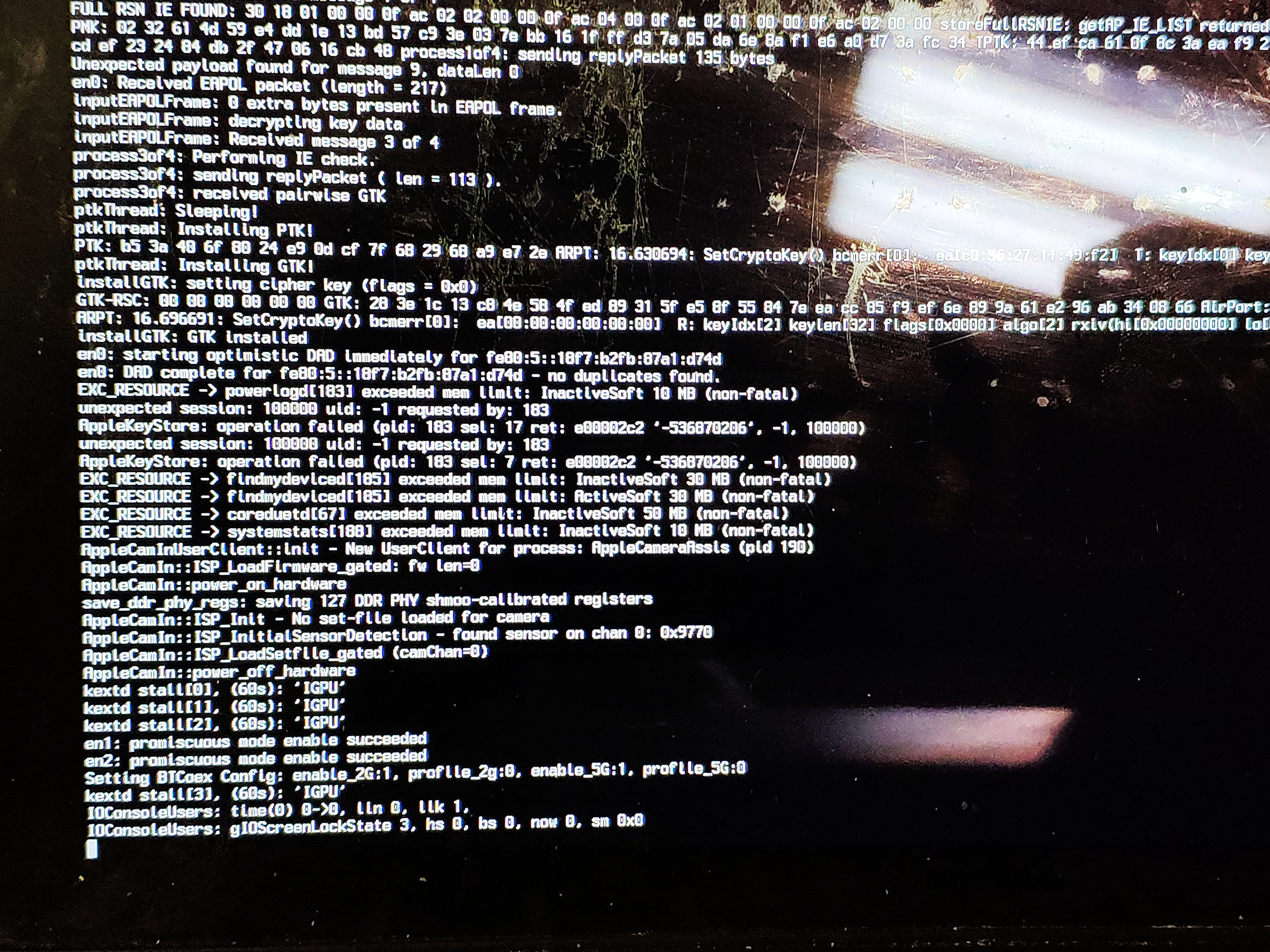

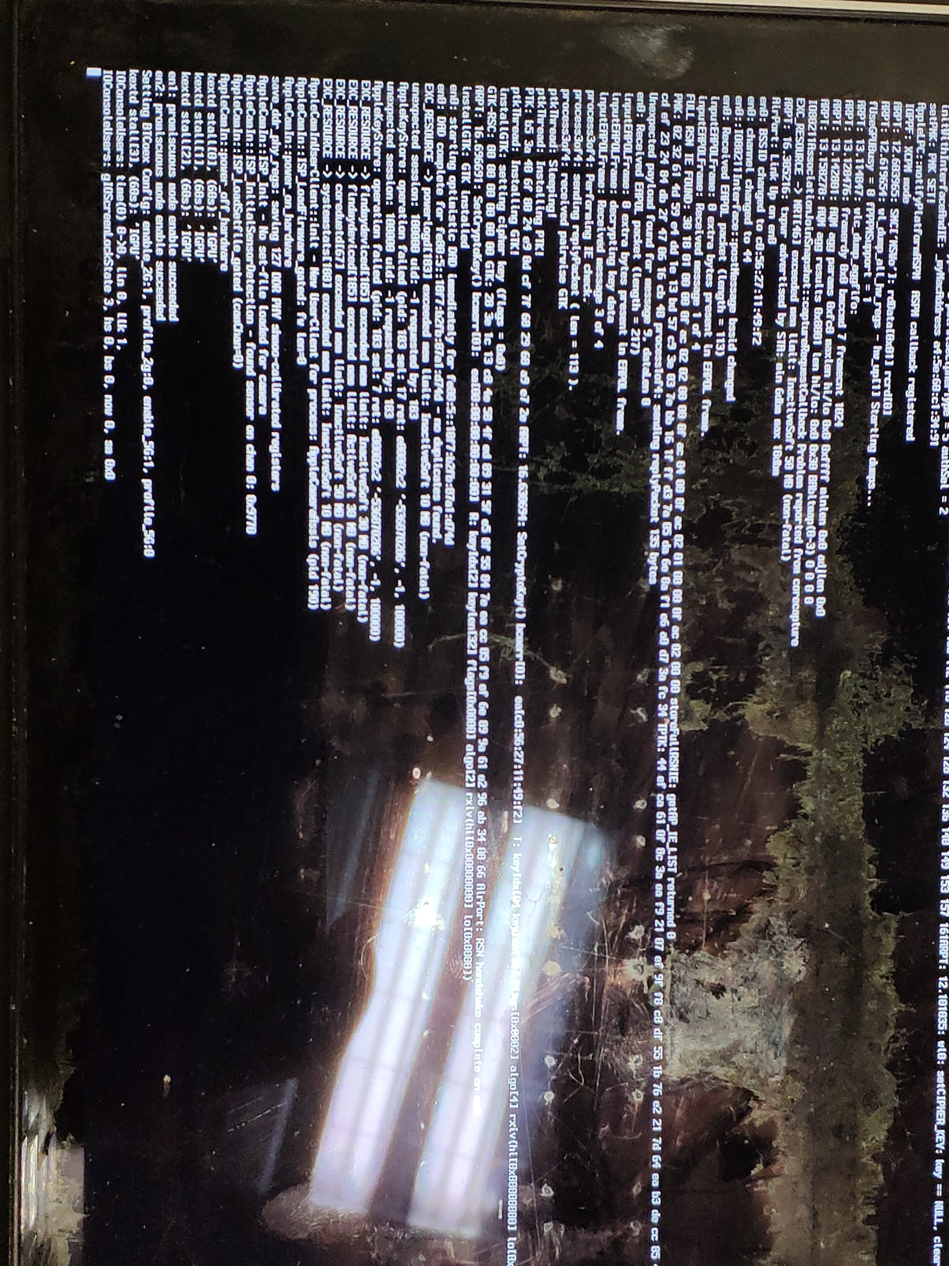

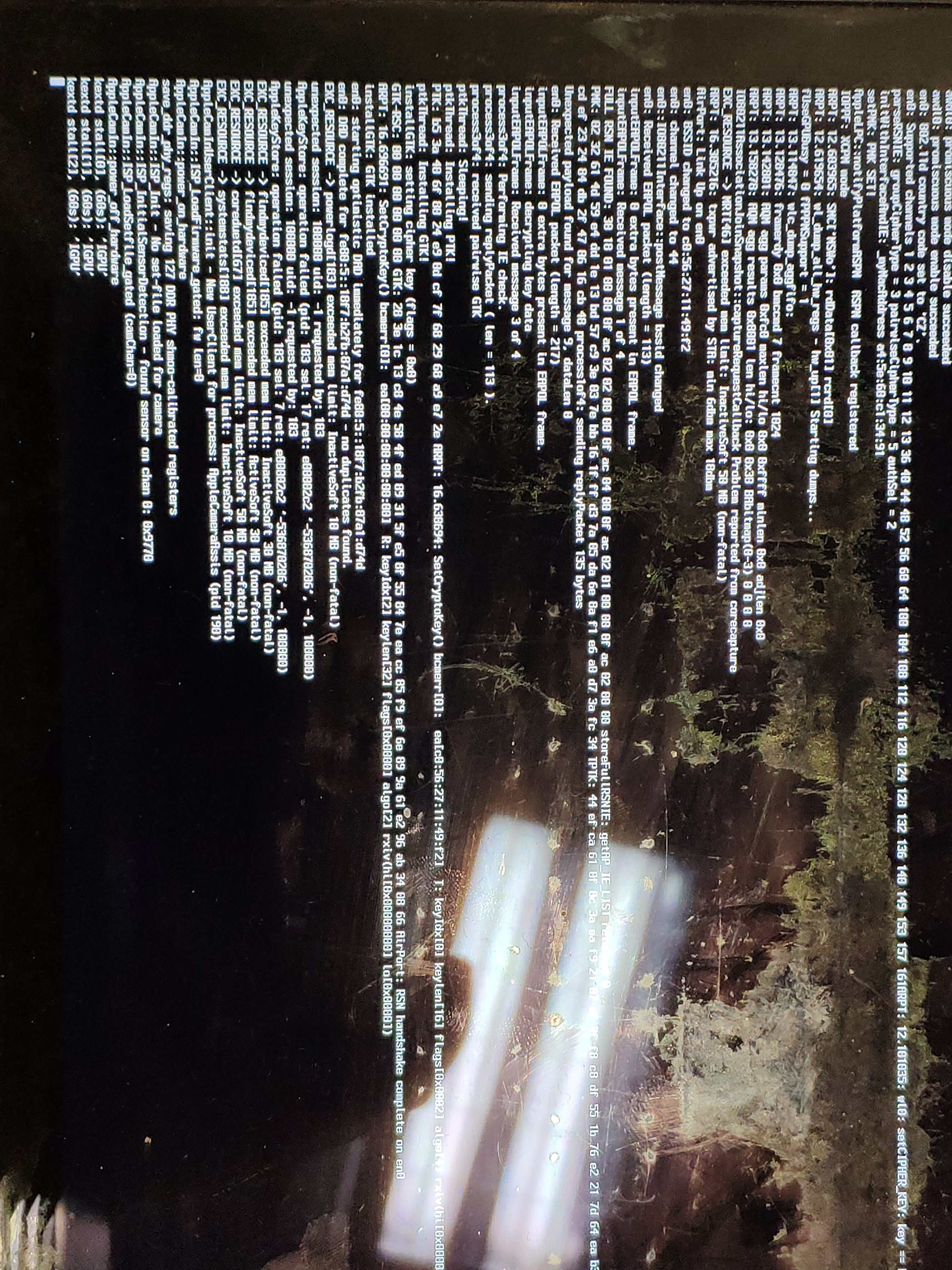

So the macbook will not boot up. It will reach 100% at loading bar and then stop forever. In verbose mode, the last thing it gives is
ioconsoleusers gioscreenlockstate 3 hs 0 bs 0 now 0 sm 0x0
but honorable mention is also "kernel stall [0], (60s): 'IGPU' (later instead of 0 is 1,2,3, it will not show up after 3) because first it stops at kernel stall and after 2-3 minutes it continues some more lines and stops at ioconsoleusers. It does not move on since that.
It will not boot into recovery mode! But it gets stuck at different part of the loading, then slowly advancing for 30 minutes until 100% loading bar and then stuck forever.
It will not boot into safe mode, or any other mode I found on the internet BUT single user mode and diagnostic mode, these two will work.

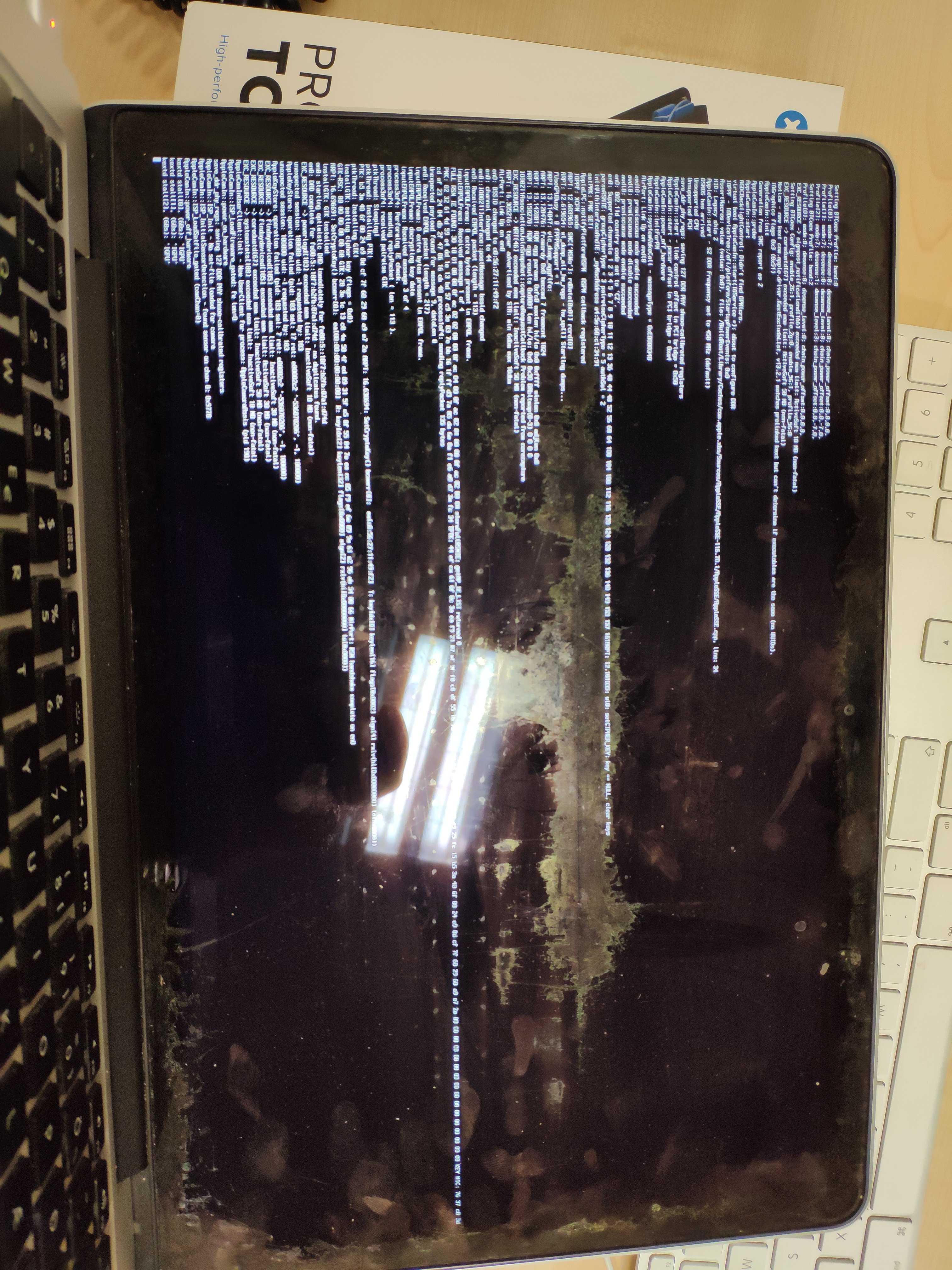

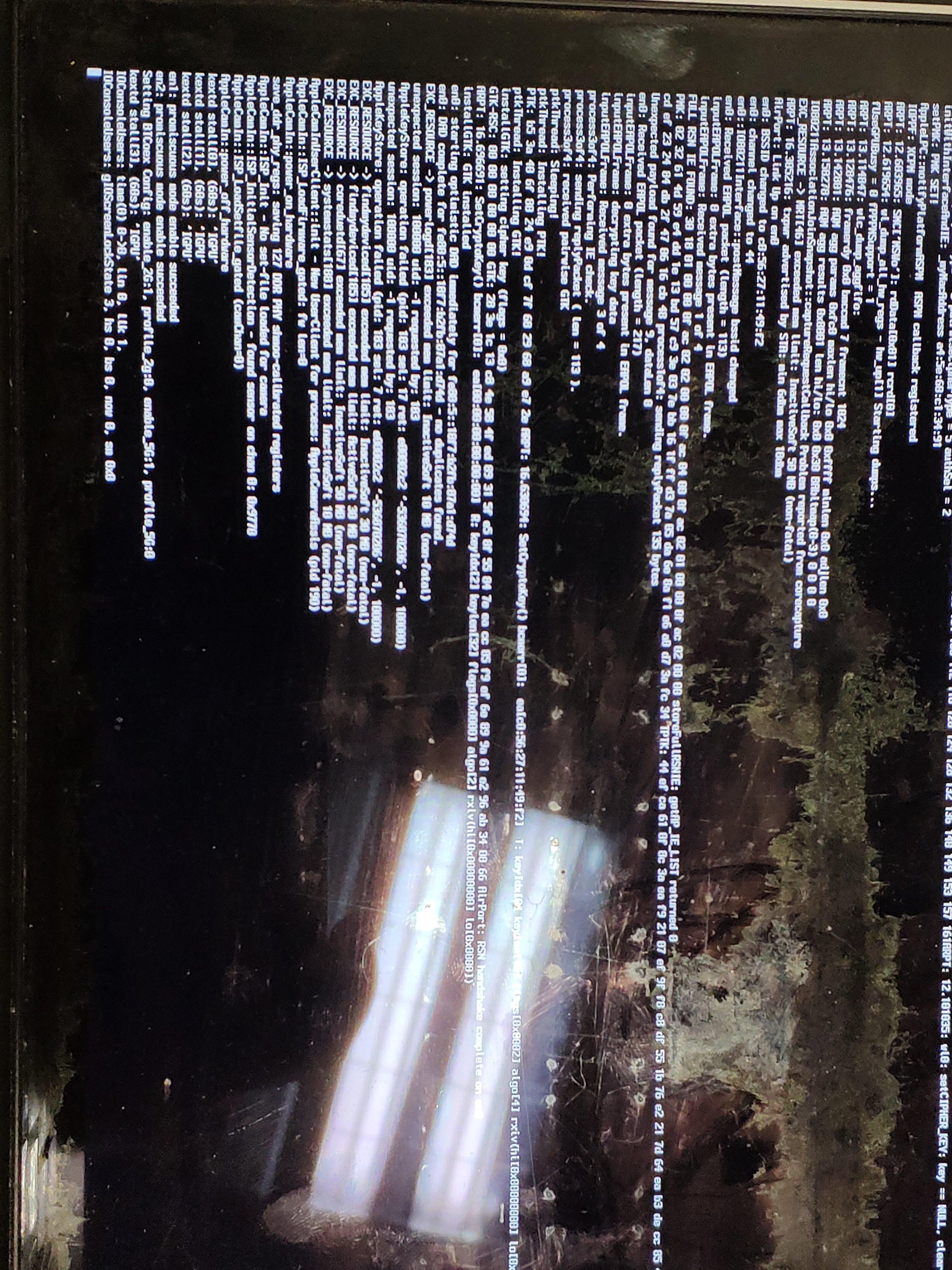

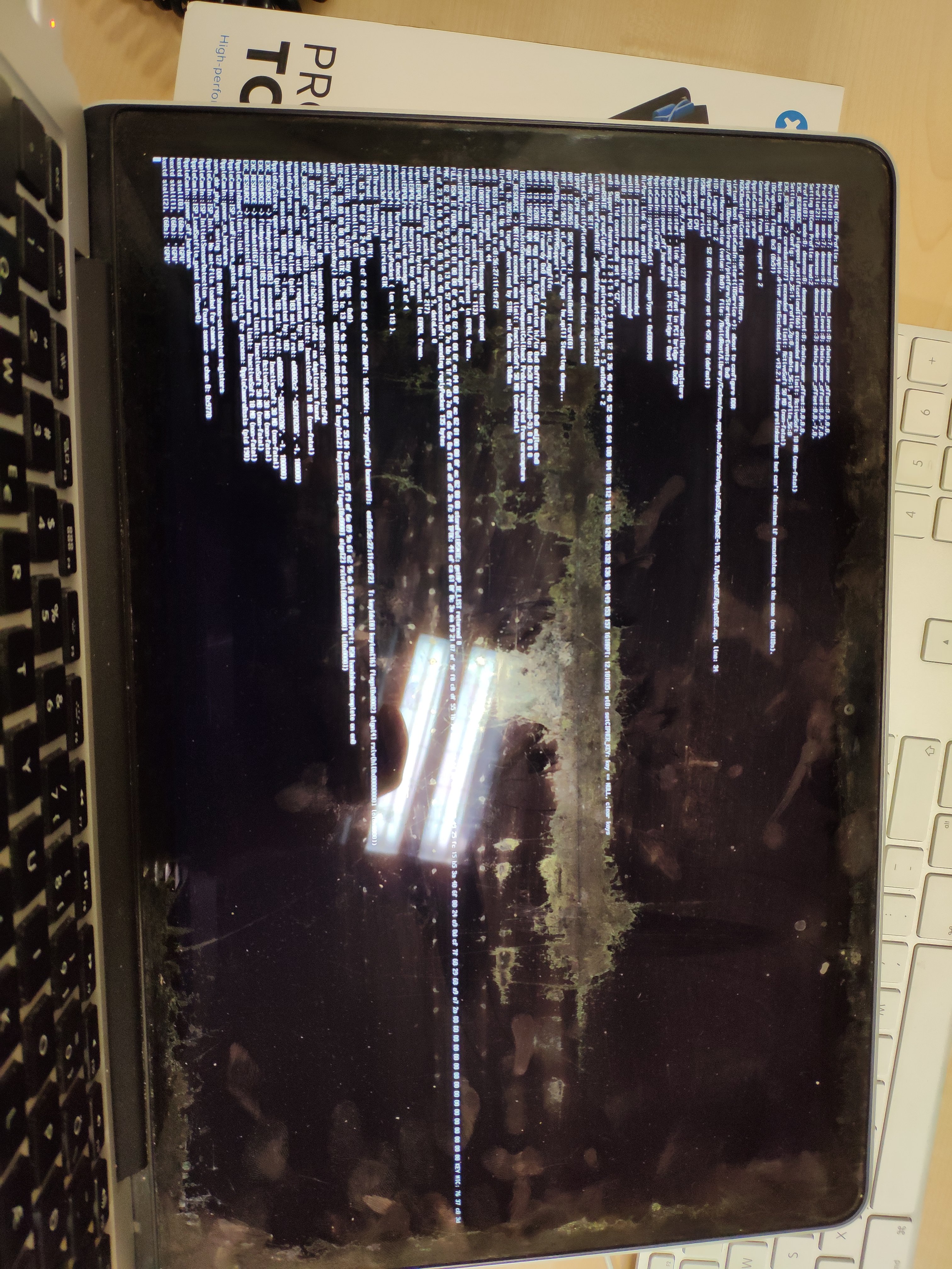

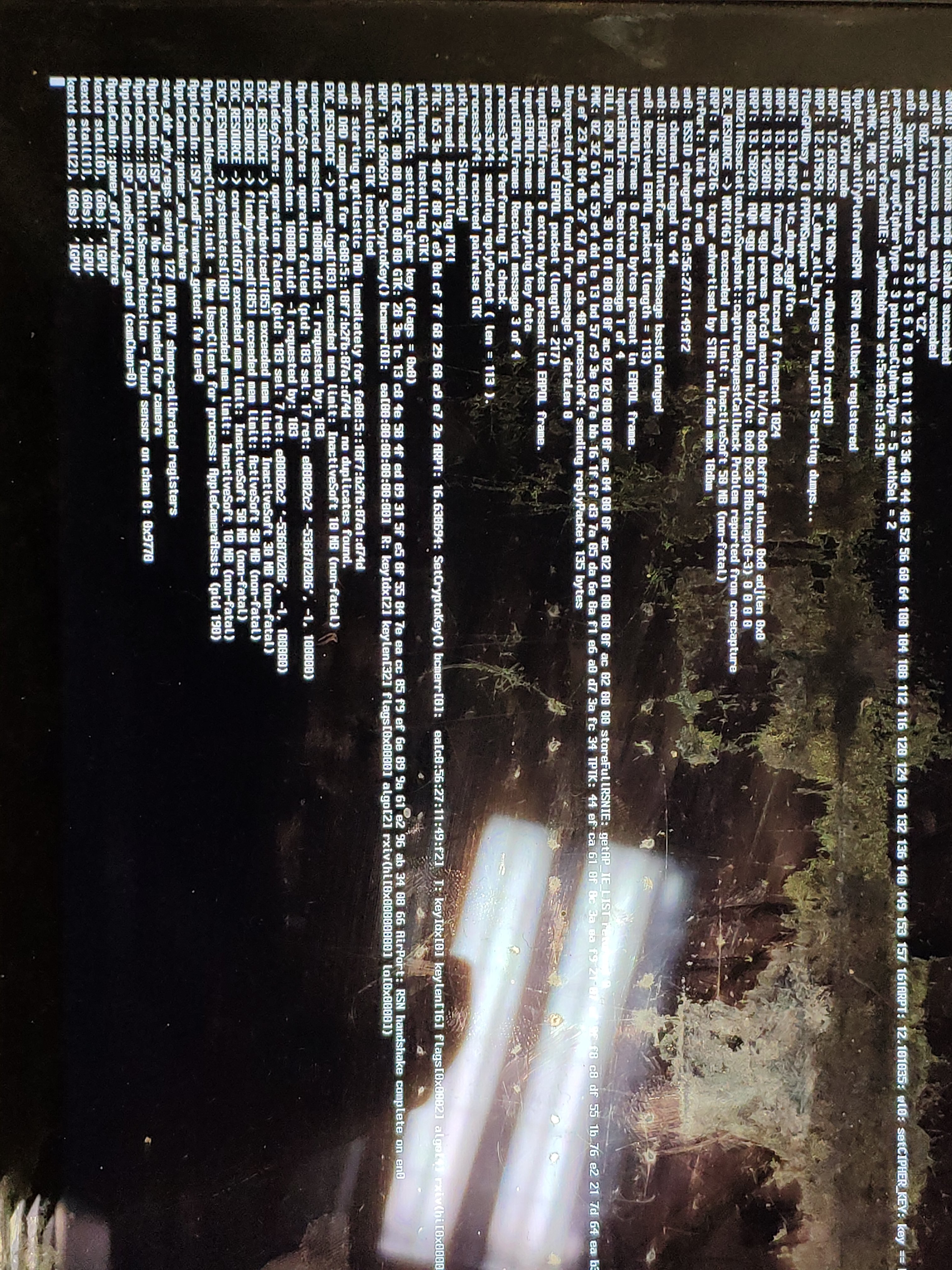

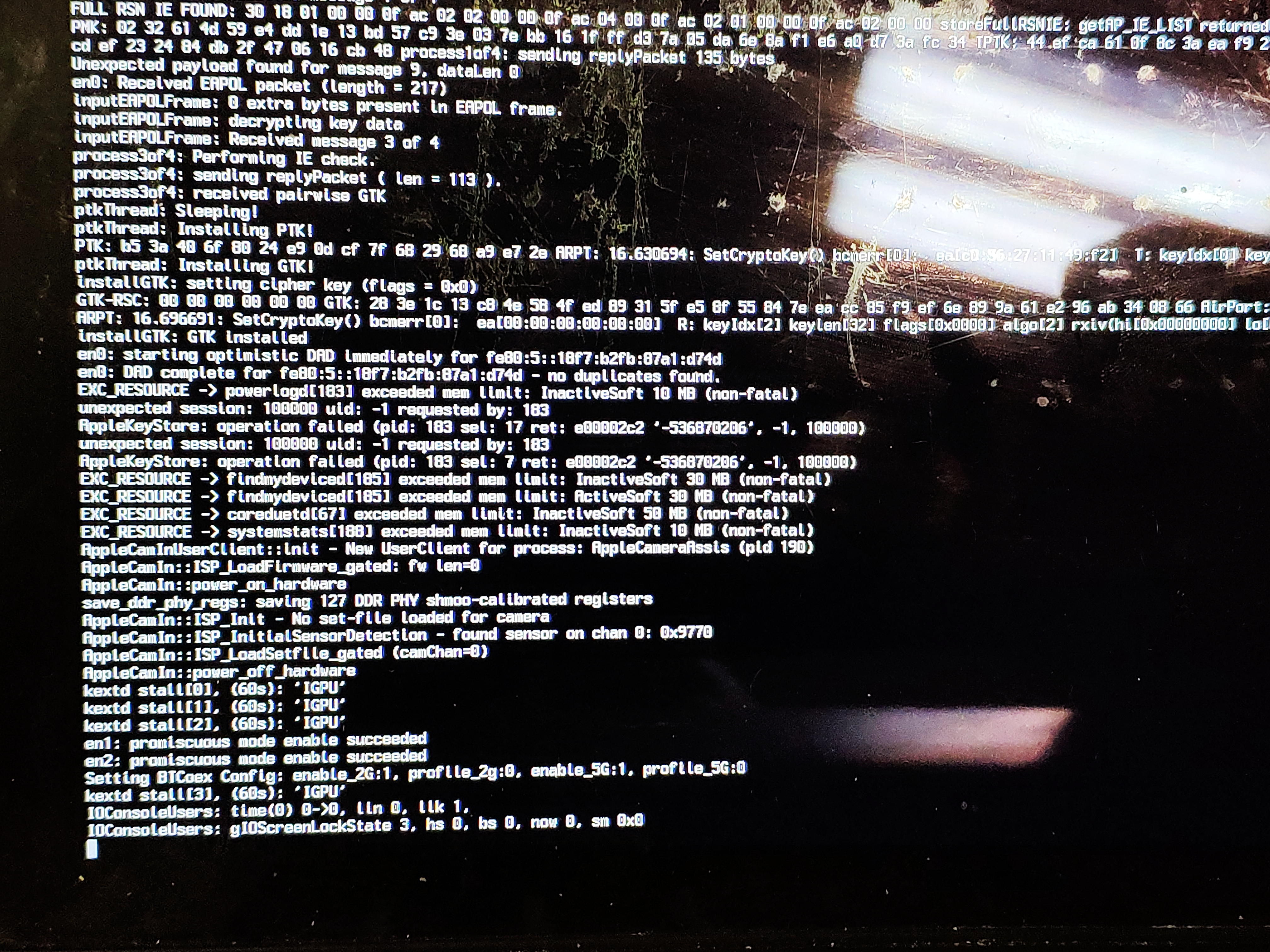

I upload some photos of verbose mode screen.
