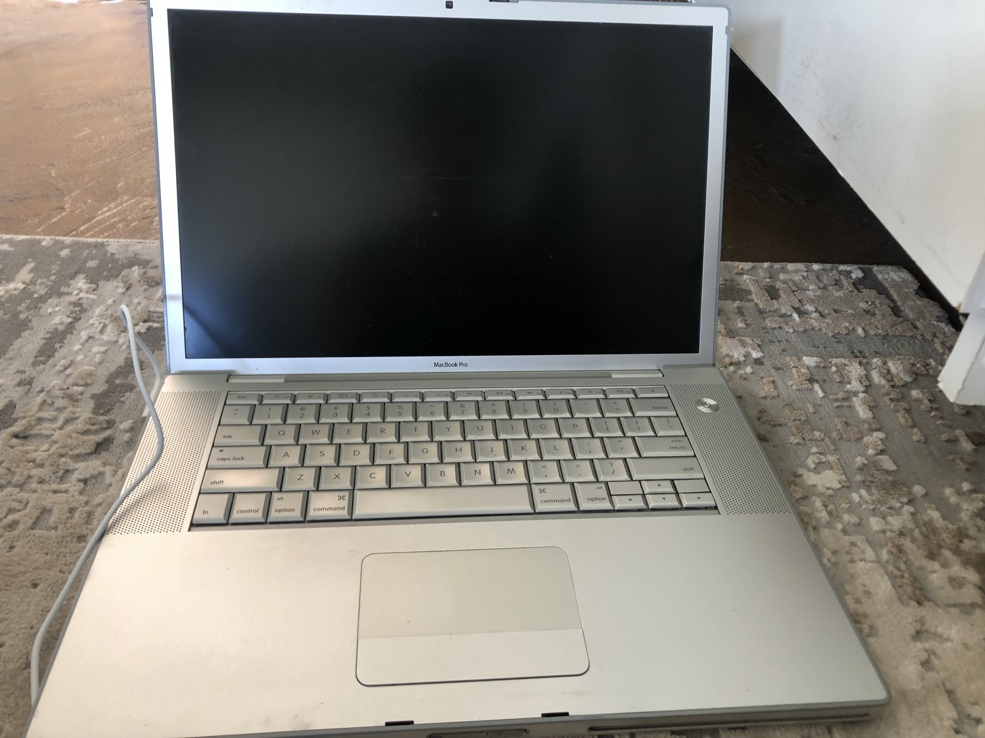

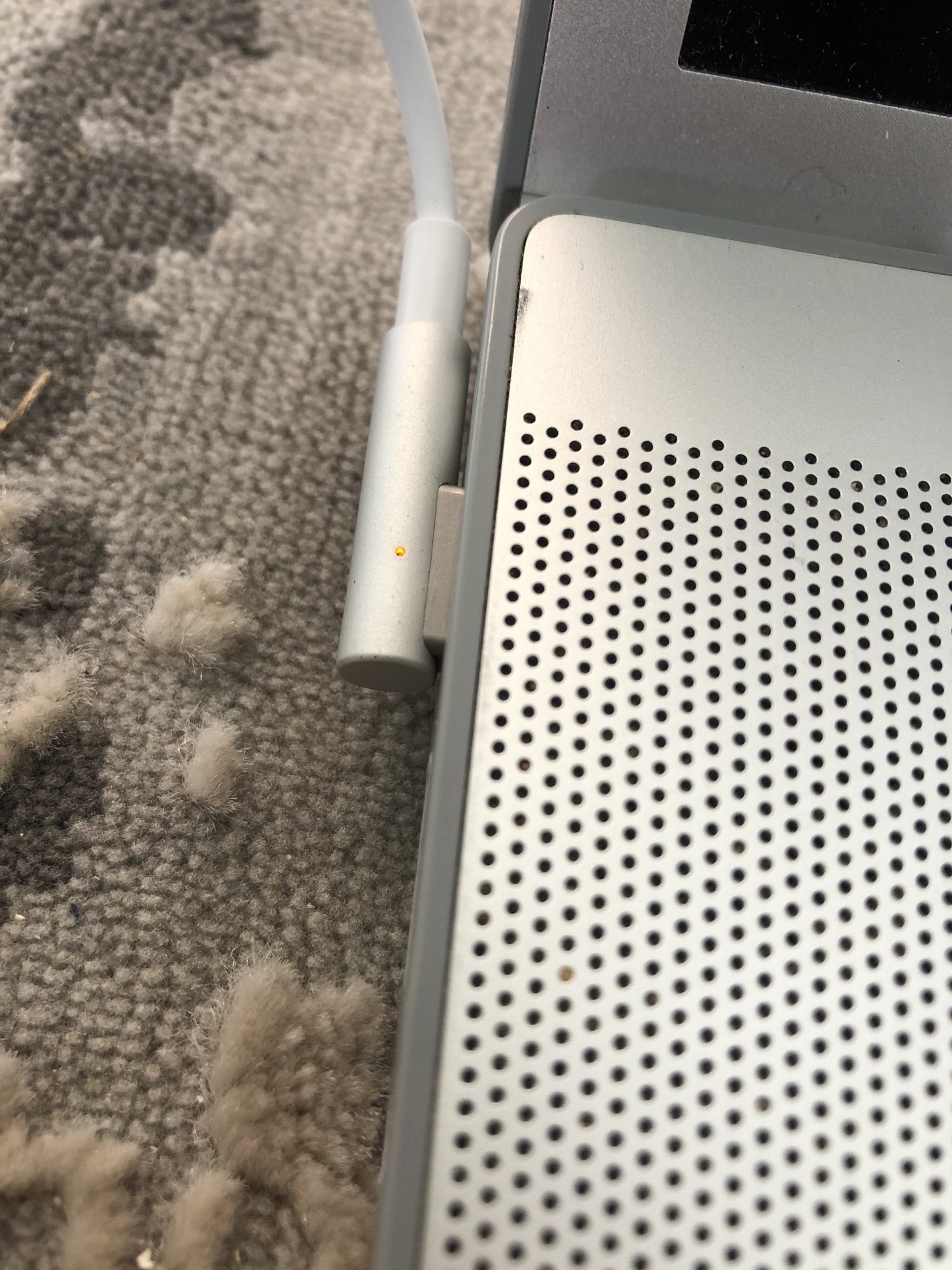

HELP-I tried all the solutions I could find online, and it has a battery, I replaced it with an apple one. Been trying for a few hours to get it running-MagSafe comes up as orange. It’s the first MacBook Pro. Images below!
If you press the test button on the battery, does that show any charge on the battery?
If you don't get any lights when you press the test button, try an SMC reset, then let the battery sit connected to the charger for 30 minutes or more, then try power again.
Does your MBPro start up if you remove the battery, and try with only the magsafe attached?
try resetting the power manager (SMC reset)

After troubleshooting since 5 PM, I hear whirring and everything and i see the white sleep light, and only stays on for as long as you hold the power button until 5 seconds when everything just shuts down. happens every time. Thoughts?

I just got it :( ,but yeah, it’s an original Apple battery that says “MacBook Pro 15 inch Rechargeable Battery”. Early 2008.
You sure the display works?
Can’t tell. It doesn’t fully turn on, I hear the drive, fans, and it shuts off automatically at five seconds. i can’t see anything with the display.
