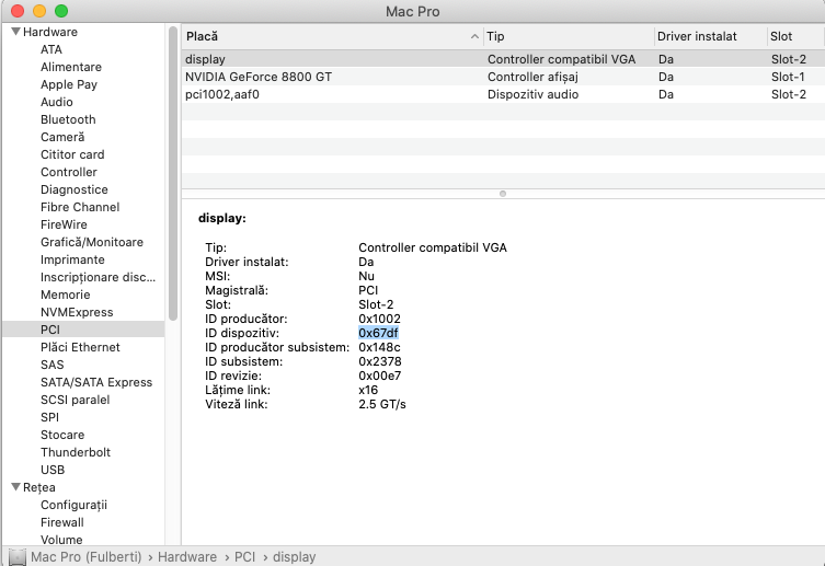

Hi to all,
I recently bought an old MP3.1 dual Xeon 2.8 Ghz with 12Gb Ram and 8800GT video card and it came with El Capitan. I managed to upgrade it to Catalina using Dosdude's patch and used the legacy video patch to get some degree of hw acceleration from my graphics card but now I got my hands on an retail RX580 and wanted to upgrade my Mac with it but can't get it to run (but strangely it works if I boot again the usb I used to install Catalina on my Mac....I mean I kept my 8800GT and added the RX580 on the other pcie x16 so I have boot screen). In the installed Catalina all I get is my 8800GT and on the second PCIEx the os sees my RX580 card as "monitor". I guess that installing the legacy patch I lost the drivers for my RX580 (that is supposed to be supported by Catalina). Is there a way to have both cards working (even if I loose the HW acceleration on my 8800GT) or at least get the rx580 fully supported even tho loosing boot menu graphics...

Plus apply the sse4.2 patch
[automerge]1593810075[/automerge]
You cant have legacy and non legacy drivers in your system setup at the same installation.
Since high sierra you also cant mix nvidia and AMD gpus.
So you have a dual situation what will not run.
1st gpu vendors mix
2nd legacy and non legacy drivers
Even a 3rd problematic situation: the amd driver needs SSE 4.2 - but this is fixable with adding an extra patch.

So to make it brief what I have to do is:
1. Install Catalina with 8800GT using the installer I created using dosdude's patcher, without installing the legacy video drivers, but apply sse 4.2 patch.
2. Shutdown MP once I have all setup and replace the gpu with RX580 and start sistem without boot image and wait until I get in osx ?

No reply from Enzo, but I can verify that the re-install without the legacy GPU patch worked for me. The RX560 is working and all the available sound options are there(headphone, digital in/out, monitor):) including sound through the HDMI.
