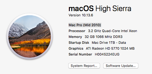

Here are system's specs:

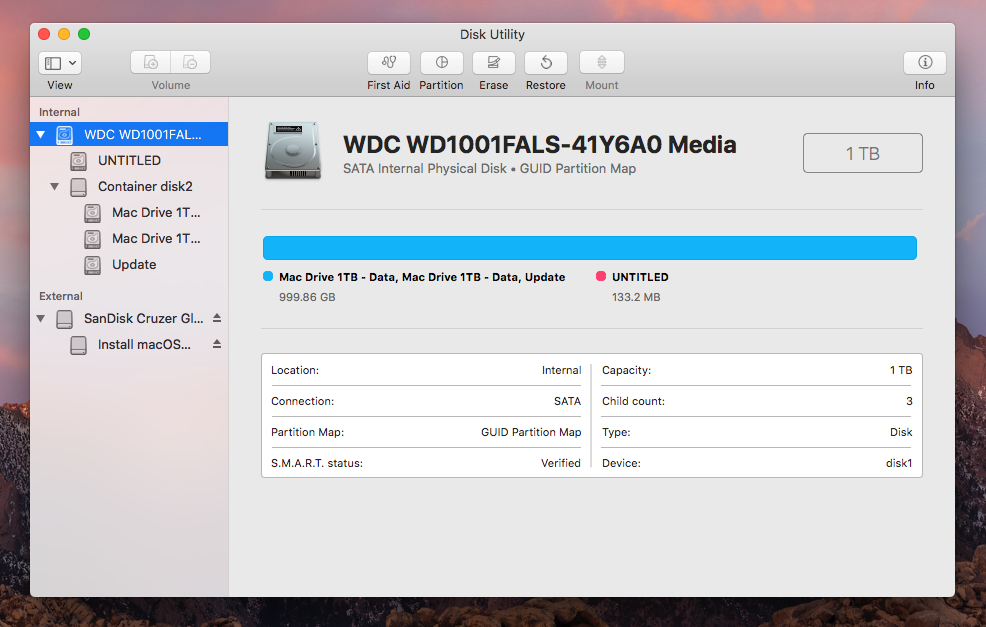

Also, I have so many drives rn. I am not sure if that is a good thing. How do I identify if I want to delete some of them? I have mounted EFI to delete OCLP files.
And this is how it shows up on Disk Utility.
