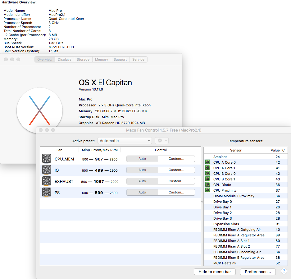

These are the fan speeds at idle after just booting up in the last configuration. With my first configuration using only OEM type RAM with the proper heatsinks, CPU_MEM is 500 and EXHAUST is 600.
Most of these configurations were tested on my MacPro1,1 flashed to 2,1 with 2 x dual 2.66 GHz. However, the last configuration was only tested on my original 2,1 with 2 x quad 3.0 GHz.
I found that once the fans hit about 900 rpm, they were audible over background noise, and the faster it gets above 900, the more annoying it gets.
