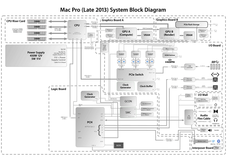

So if I understand correctly to use D700 for graphic work (like video editing in this case) it should be the B board? And the A board is for compute only (running the displays etc?)
So A board would be the old D300 (in my case) and new D700 would go to B board. I found this diagram about Mac Pro 6.1 wich states that the TD ports go to B board.

Finally, by "B board" do you mean the card fitted in the so-called "Slot-2" in System Profiler (since this is always marked as the graphics card where the display are connected)?
The rendering GPU will also responsible for display as well. Therefore, GPU B actually can do ANYTHING. If in doubt, go for GPU B.

The system block diagram shows that B board holds the TB connectors and "Slot-2" in System Profiler matches this. For reference i have DELL UP2715K with 5k resolution connected to mac and it show up in slot-2.
