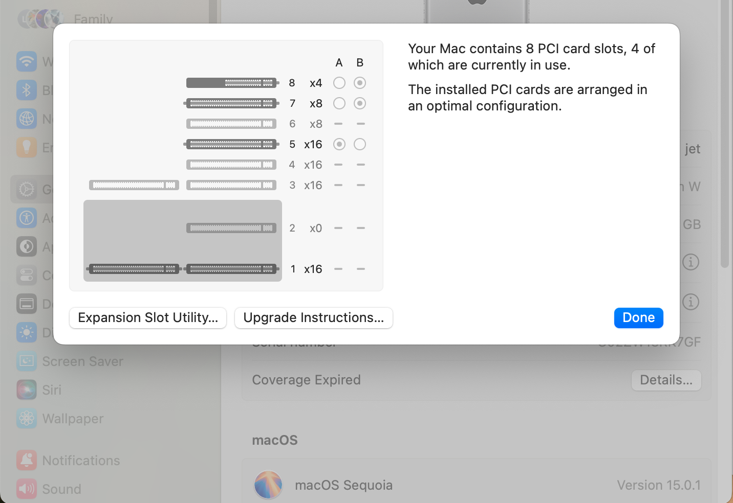

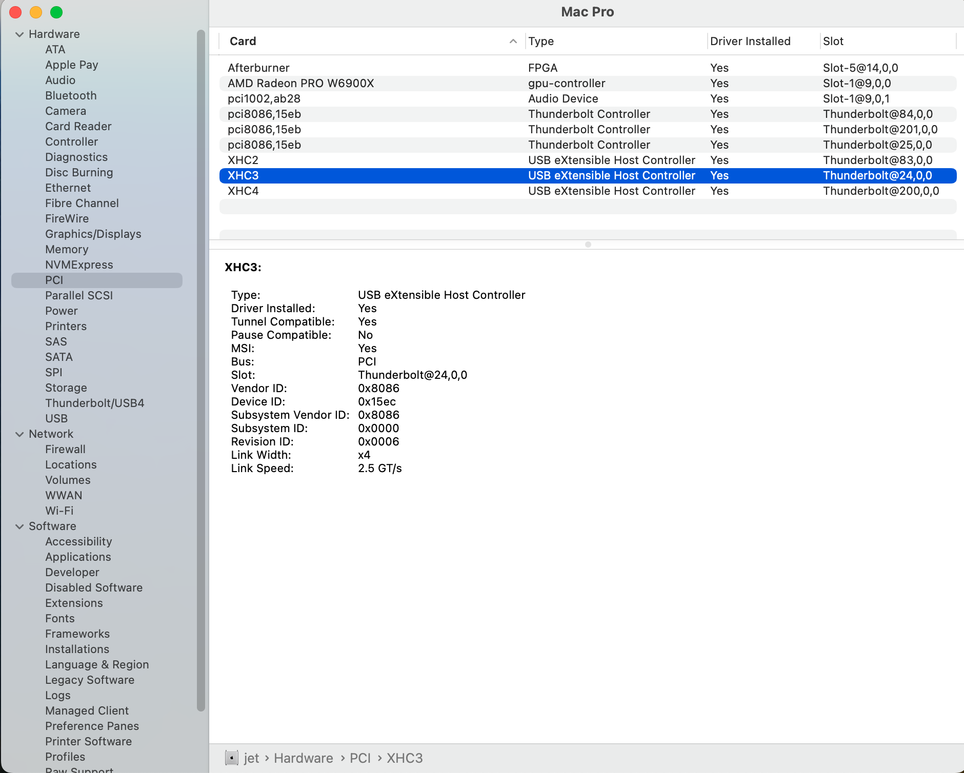

Hi Ivion & others,
not sure if you are still using your Mac Pro 2019 with Afterburner & Areca ARC-1883, but I have hit the same problem.
I have Mac Pro 2019 (Sonoma 14.6.1) with W6900X (slot #1), Afterburner (slot #5), Areca ARC-1883LP (slot #6) & Apple I/O (slot #8) PCIe cards installed.
Every time time I have both Afterburner & Areca ARC-1883LP installed then Areca card gets "lost".

Looking at the "System Report" (you can see that the Areca is not visible in report) there seems to be a lot of "Thunderbolt" devices on the PCI report, which are not visible as part of allocation:
Any suggestions how I might get my Mac Pro to work with both Afterburner and Areca ?
NOTE: I have installed the latest firmware on Areca card and latest ArcMSRu drivers into MacOS.

UPDATE #1:
Upgraded MacOS to Sequoia, moved Areca ARC-1883LP from slot #6 to slot #7 and reset to "Automatic Bandwidth Configuration.
Boom!! Areca card now visible again and auto configured correctly (Apple I/O + Areca in Pool B and Afterburner in Pool A):
I had previously put the Areca in slot #6 so the fan had more breathing space (it is now blowing straight up on the Apple I/O card).
