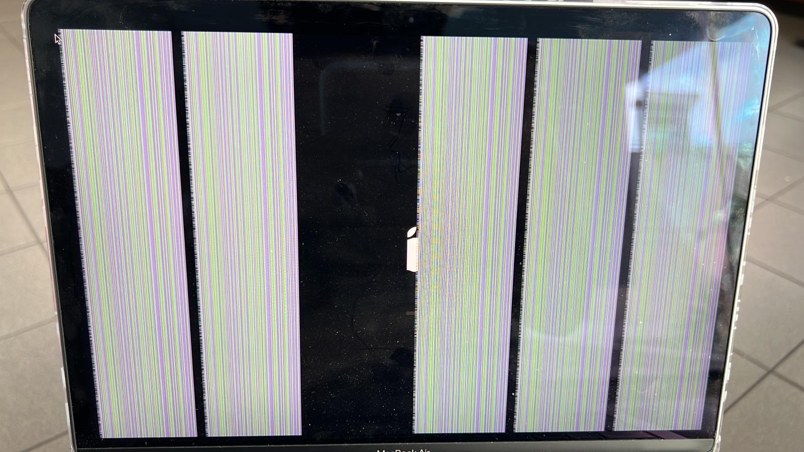

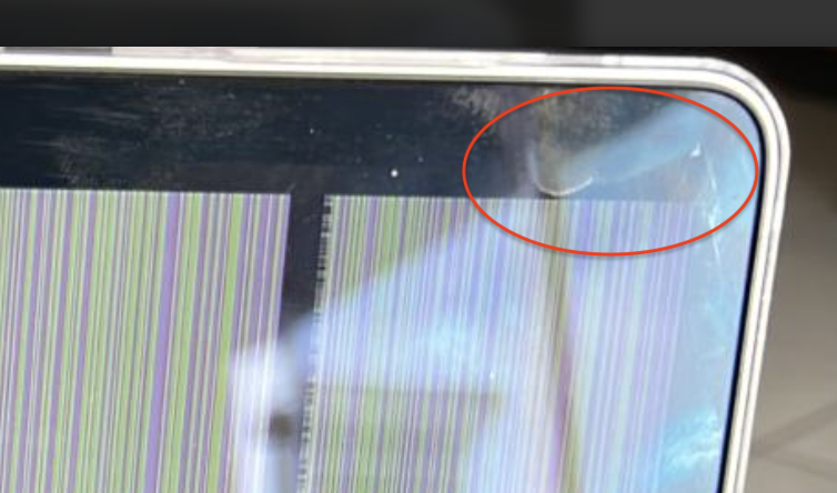

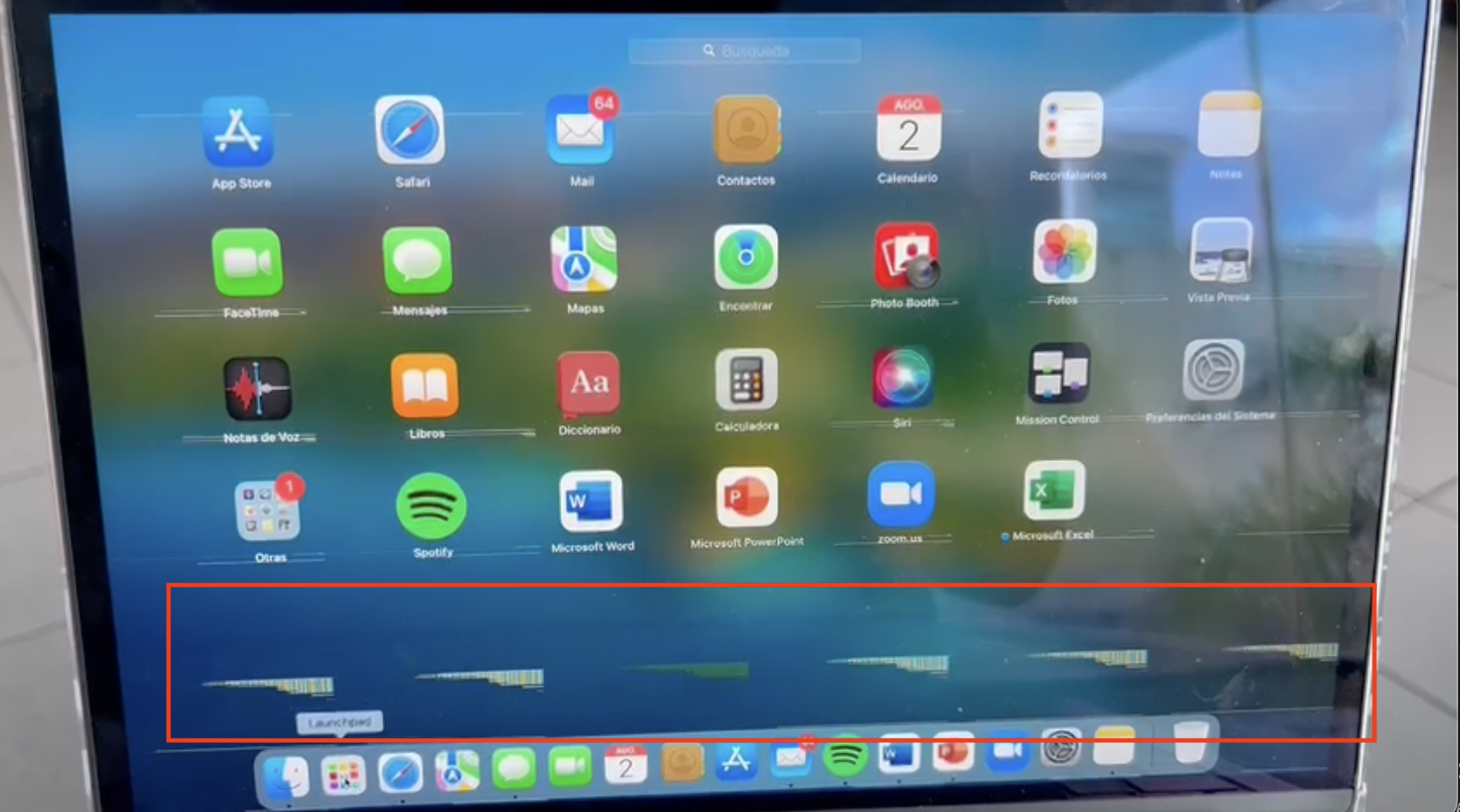

My mom called me today (hysteric) and send me these pictures from her MBA M1 (bought it +1 year ago), it happened suddenly. Any suggestions? She's living in a country that sells MacBooks (Costco, Sams, BestBuy) but there's no Apple Store nor authorized service providers (I searched thru Apple website). I was trying to help her we updated the software, hard reset (press down power 'til turned off), tried to erase hard drive and reinstalling macOS or safe mode but couldn't see the screen (see photo). Once apple logo "goes away" (and the vertical lines), the login screen and everything else shows horizontal pattern lines (second photo). Any help will be more than welcome.

I've seen similar problems in laptops before. Vertical color stripes = no bueno. It usually is a hardware problem, including bad/disconnected/broken flat/ribbon cable, possibly a chip issue. Your best hope is it's a cable interface/seating issue, which can be fixed fairly simply, but I think it's going to be something worse.
Prior poster has it right. Plug in an external monitor to the Air and see if the Air can drive the display. If the external display image looks normal, it is almost certain you've had a display hardware failure -- and it's likely you'll need a professional to fix it.

Yeah that seems plausible. I didn’t jump to it because I couldn’t see any cracks, but seems like these m1 screens are pretty fragile.
this happened to a friend's macbook air some years ago; she bent the screen back too far, and damaged the connection to the base (not saying it's exactly the same issue, but possible). she took it to an apple store, and luckily, they fixed it under applecare.
