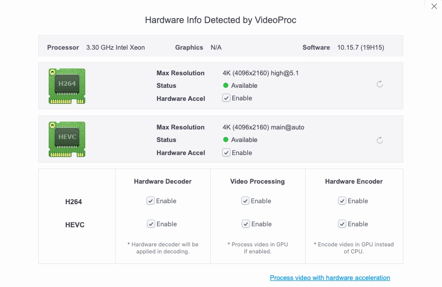

I can confirm that OpenCore hardware acceleration in Big Sur 11.2.1 still works as expected for both H264 and HEVC. 👍

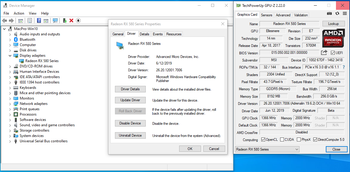

@DevoAtari , I spent several months using OpenCore without a boot picker, assuming I misconfigured something. After an entire day troubleshooting it, I found that swapping to my other GPU (also an RX 580) showed the boot picker.
Recently, the very knowledgeable and credible Martin LO (@h9826790) speculated that 80 percent of the time a GPU won't show the OpenCore boot picker is because the card was flashed with a non-factory firmware by the previous owner. Further, he says that 99% of the time a card can be fixed by flashing the card back to factory state:
I was reassured to learn this, and I'm now certain the problem with my card was a non-factory firmware flashed by the previous owner. TechPowerUp shows seven available factory ROMs for my Sapphire Pulse RX 580. Though I have never flashed GPUs myself, I'd be fairly confident in my ability to try flashing different factory ROMs until I found one that worked. I see 2 or 3 ROMs that I'd try first. My methodology would be to match the installed memory manufacturer part number to the firmware I downloaded. I think it's important to mention the obvious that the factory firmware will safely fit onto the 256KB factory VBIOS chip, whereas the MacVidCards firmware requires a larger VBIOS chip. This is another reason why I think the $100 cost is reasonable for the upgraded chip, soldering expertise, and proprietary firmware.
However, what I'm not certain about is whether a single-BIOS card can be flashed without a 2nd card present. That is, how can you flash it at the same time you're using it?

Seems all the MSI ROMs listed in the TechPowerUp repository bring back a "mismatched system identification" error. Tried the only other reference BIOS (a Dell), tried any other card appearing to use a reference board layout, and also tried cards that have the same port layout. Still the same error. All ROMs attempted have the same memory, Samsung K4G80325FB.
I’m worried about using the command line utility to force a flash, since this is a single BIOS card.

Trying to find someone that has my card to dump their ROM. Can't seem to figure this out. Even tried contacting MSI to see if they'd give out the original ROM, and absolutely no one is surprised that they quickly said no.
