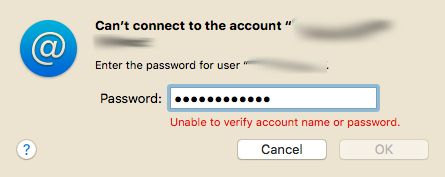

I've unfortunately messed around with Keychain (because the spinning beachball appears a lot, for no apparent reason, and I read about how the keychain can be the cause of this), deleting stuff I thought was OK.
Now I'm having problems with Mail app asking me for account passwords which apparently won't work despite being the correct ones, such as in this error message:
I suspect the error to be within the Keychain and since I don't have a lot of passwords etc. on this particular Mac I'm OK with starting from scratch again. I've been searching around for info on how to completely reset Keychain, but so far only found instructions on how to fix particular things within it (time consuming!). There are lots of untrusted and expired certificates as well, and a bunch of certificates with the same name.
