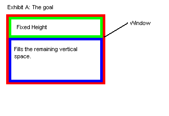

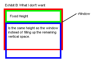

Is it possible?
I have two divs. One has a fixed height and I want the other one to fill the remaining vertical space on the window. If I set the latter div's height to 100%, it'll make it the same height as the window, but I want it to be the height of the window minus the height of the first div.
This is the code I'm using:

I also included some images that show what I want to do and what I've been able to do so far. Thanks in advance

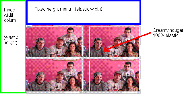

The grand scheme of things
Ok here's a pic of my ultimate goal. So far I've been doing it gradually, so maybe the problem is my initial approach. So how would you guys approach this (I just need ideas)? Would you use pure css, or would you give in to tables or frames?

Thanks for all the help guys, but I just realized that the exact layout that I want is impossible to achieve with a combination of fixed widths/heights and percentages. I rewrote it using only percentages and now it works :cool: . If you are interested in the markup let me know and I'll post it.

The easiest thing to do to learn this stuff is to stop using Dreamweaver. I design my sites in Photoshop and then save the graphical elements that I want, along with jotting down colour codes and some rough pixel measurements for alignment purposes, and then I code the site in TextWrangler or VIM.

I'd like to have a look if you've got the time to post again.
Here it is, there's a bit of spanish in there, I hope it's not too confusing:
Code:

For best results, download the picture and save it as test.jpg ;)
