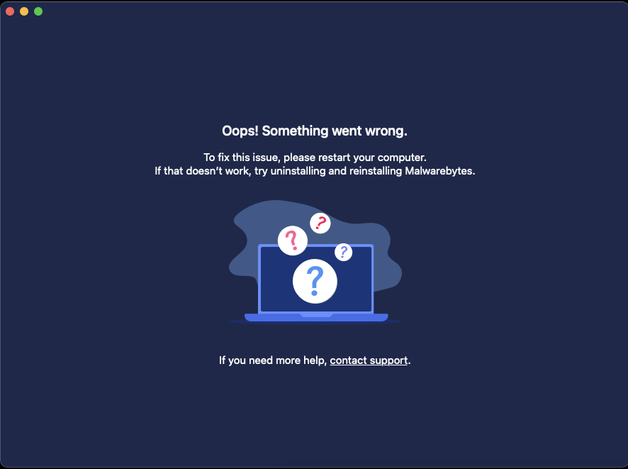

Hi all,
I upgraded to macOS 11.3.1 and since then I get the below error when I try to open the Malwarebytes app.
I have tried restarting and still get the same error.
Questions:
Q1. How do I cleanly uninstall the app if I can't open it, to hit the 'uninstall' button?!
Q2. Can I simply try re-installing over the top of it? Or does the Mac just flag the files are already installed etc.?
Q3. Does this happen for a lot of popular apps? Or is it just pure bad luck it had to be this one?
The error message:
Thomas Reed from Malwarebytes here... we're seeing the same thing here, and aren't yet sure of the cause, but it's being investigated. For now, this is easily fixed by doing one of the following things:
  • Restart your computer a second time after installing the Big Sur 11.3 or 11.3.1 update
  • Reinstall Malwarebytes right on top of your existing installation (no need to restart)
Either of these should be sufficient to get it up and running again.

I can't speak for Intego, but that wouldn't cause the issue described here with Malwarebytes. If, for some reason, Malwarebytes for Mac does not have full disk access, it will show a very different message. It will still allow you to scan (albeit with reduced efficacy), though not turn on real-time protection.
Also, I can say that I have reproduced the issues with the 11.3 and 11.3.1 updates on an M1 machine with only one admin account.
