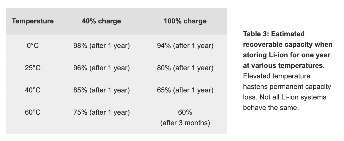

This way, I am keeping the battery level always between these level of percentages. Theoretically, you are still cycling your battery but I believe it is better than just keeping it at 100% all times (see below Table 3 showing <80% capacity remaining after 1 year the battery is stored at 100% charged state)

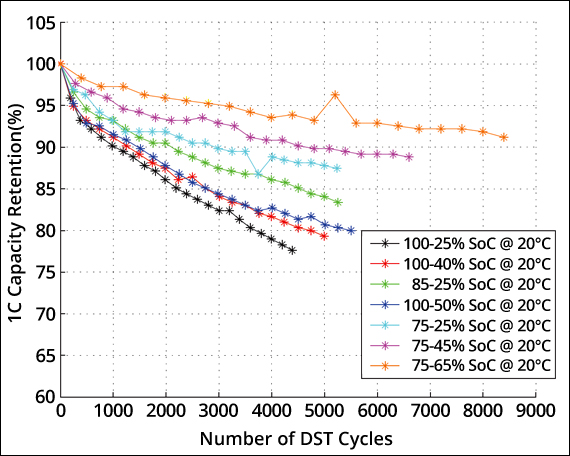

You could even keep it between 65% and 75% and get the longest cycle life out of your batteries (see figure 6 here). I don't claim this way is the best thing to do, however based on my knowledge there is a chance this might be better than just keeping it plugged in and at 100% all the time. By the way, I am following the same for my iPhone 12 Pro - never charging it above 85% and never letting it go below 25%. Even though iOS has the battery health management, I just want to be in control of the management.

Figure 6: Capacity loss as a function of charge and discharge bandwidth.*
Charging and discharging Li-ion only partially prolongs battery life but reduces utilization.
Case 1: 75–65% SoC offers longest cycle life but delivers only 90,000 energy units (EU). Utilizes 10% of battery.
Case 2: 75–25% SoC has 3,000 cycles (to 90% capacity) and delivers 150,000 EU. Utilizes 50% of battery. (EV battery, new.)
Case 3: 85–25% SoC has 2,000 cycles. Delivers 120,000 EU. Uses 60% of battery.
Case 4: 100–25% SoC; long runtime with 75% use of battery. Has short life. (Mobile phone, drone, etc.)
TABLE 3:

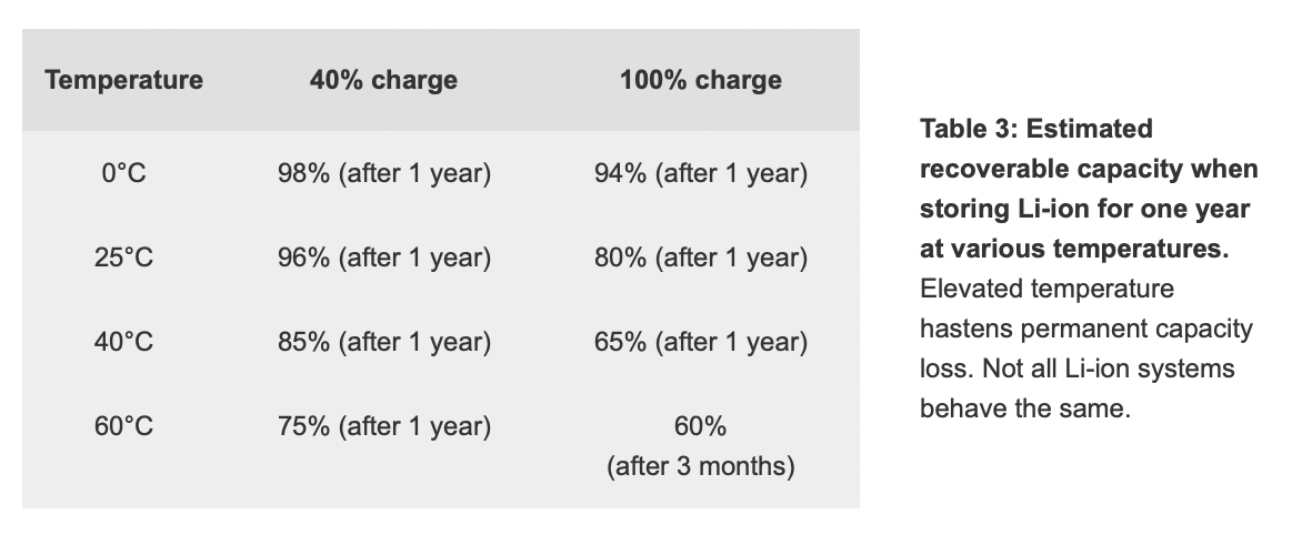

This way, I am keeping the battery level always between these percentages. Theoretically, you are still cycling your battery but I thought it would be better than just keeping it at 100% all times (see below Table 3 - <80% capacity left after 1 year the battery is left at 100% charged state)
You could even keep it between 65% and 75% and get the longest cycle life out of your batteries (see figure 6 here). I am in no way to claim this is the right thing to do, however based on my knowledge there is a chance this might be better than just keeping it plugged in and at 100% all the time. By the way, I am doing the same for my iPhone 12 Pro - never charging it above 85% and never letting it go below 25%. Even though iOS has the battery health management, I just want to be in control.
TABLE 3:
TABLE 3:
