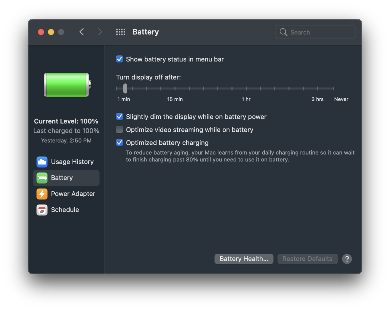

Try turning off 'optimized battery charging' setting to see if it makes a difference. Curious which port you're using to charge, towards rear or towards front?
is there one you should use over the other? asking for a friend 😅😅
For battery settings I normally leave default unless troubleshooting an issue like having to turn off auto brightness. For charging ports, it shouldn't matter and I haven't had issue with towards back but you never know. Seems like every day is a surprise.

Optimized charging was off. Now even if it is on, it charges correctly.
