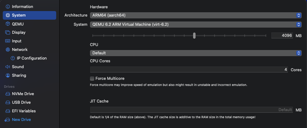

3. How many Cores (vCPU) can I assign to the VM?
1. Can or should I change the socket and threads, both have = 1
2. -smp cpus=2,sockets=1,cores=2,threads=1
4. What would be any other best settings to run in UTM? Or for QEMU?

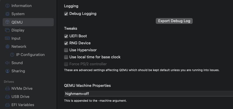

1. Any particular setting I should change or make sure has a certain value? I have attached the current settings, the “main” ones in pic and a “full” in text.

QEMU Arguments (Command)
Code:
qemu-system-aarch64
-L /Applications/UTM.app/Contents/Resources/qemu
-S
-qmp tcp:127.0.0.1:4444,server,nowait
-nodefaults
-vga none
-spice "unix=on,addr=/Users/executive/Library/Group Containers/WDNLXAD4W8.com.utmapp.UTM/68A863C7-FE76-49F9-AC77-36D87894C157.spice,disable-ticketing=on,image-compression=off,playback-compression=off,streaming-video=off,gl=off"
-device virtio-ramfb
-cpu cortex-a72
-smp cpus=4,sockets=1,cores=4,threads=1
-machine virt-6.2,highmem=off,virtualization=on
-accel tcg,tb-size=1024
-drive if=pflash,format=raw,unit=0,file=/Applications/UTM.app/Contents/Resources/qemu/edk2-aarch64-code.fd,readonly=on
-drive "if=pflash,unit=1,file=/Users/executive/Library/Containers/com.utmapp.UTM/Data/Documents/Windows 11.utm/Images/efi_vars.fd"
-boot menu=on
-m 4096
-device intel
-hda
-device hda-duplex
-name "Windows 11"
-device nec-usb-xhci,id=usb-bus
-device usb-tablet,bus=usb-bus.0
-device usb-mouse,bus=usb-bus.0
-device usb-kbd,bus=usb-bus.0
-device qemu-xhci,id=usb-controller-0
-chardev spicevmc,name=usbredir,id=usbredirchardev0
-device usb-redir,chardev=usbredirchardev0,id=usbredirdev0,bus=usb-controller-0.0
-chardev spicevmc,name=usbredir,id=usbredirchardev1
-device usb-redir,chardev=usbredirchardev1,id=usbredirdev1,bus=usb-controller-0.0
-chardev spicevmc,name=usbredir,id=usbredirchardev2
-device usb-redir,chardev=usbredirchardev2,id=usbredirdev2,bus=usb-controller-0.0
-device nvme,drive=drive0,serial=drive0,bootindex=0
-drive "if=none,media=disk,id=drive0,file=/Users/executive/Library/Containers/com.utmapp.UTM/Data/Documents/Windows 11.utm/Images/Windows11_InsiderPreview_Client_ARM64_en-us_22533.qcow2,discard=unmap,detect-zeroes=unmap"
-device usb-storage,drive=drive1,removable=true,bootindex=1,bus=usb-bus.0
-drive if=none,media=cdrom,id=drive1
-device virtio-net-pci,mac=92:C1:68:1D:C6:42,netdev=net0
-netdev vmnet-shared,id=net0
-device virtio-serial
-device virtserialport,chardev=vdagent,name=com.redhat.spice.0
-chardev spicevmc,id=vdagent,debug=0,name=vdagent
-device virtserialport,chardev=charchannel1,id=channel1,name=org.spice-space.webdav.0
-chardev spiceport,name=org.spice-space.webdav.0,id=charchannel1
-uuid #######-####-####-####-############
-device virtio-rng-pci
