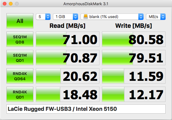

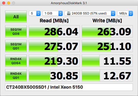

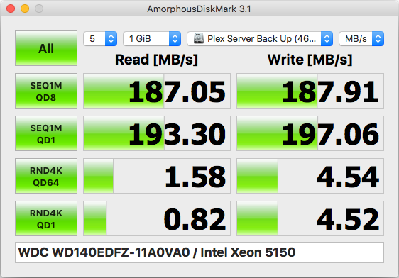

Here is a single internal HDD in my Mac Pro 1,1 versus a single SSD externally over FW800 and USB2. The sequential speeds are clearly better with the internal HDD, but look at the random speeds. The FW and USB beats the HDD many times over. This is the main reason why people use SSDs in older Macs.
HDD:
SSD over USB2:
SSD over FW800:
A lot of people don't know this, but you can run TB3 NVMe SSDs as a boot drive on your older 2012 Mac Mini.
I found a YouTube for installing such in a 2014, looked to be plug and play with the proper board.

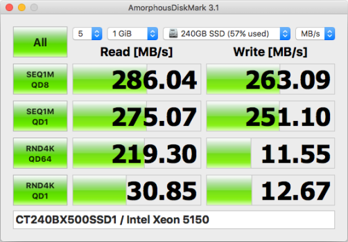

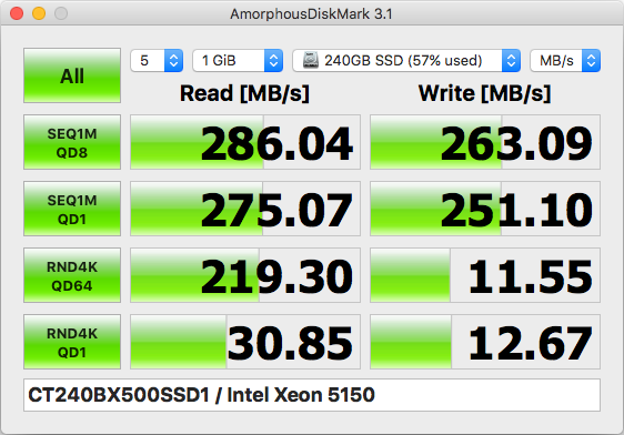

Oh, I found a single SSD over SATAII, pretty sure it was with my Mac Pro 1,1. Yes, the sequential is faster on the SSD as expected, but look at the difference with random read speed versus the internal HDD, 14,000% faster:

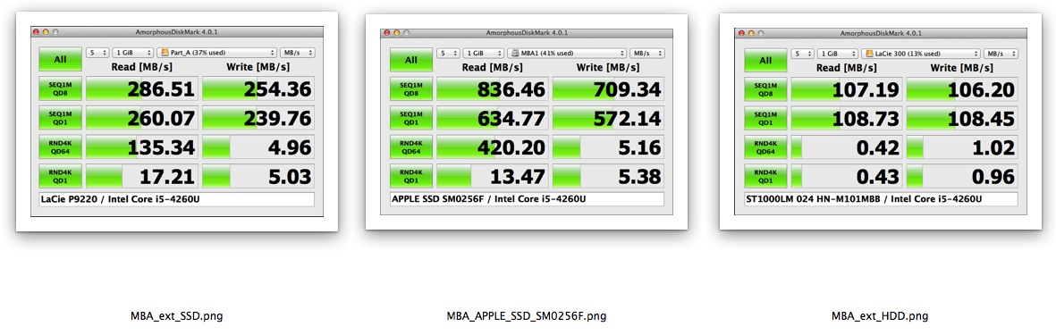

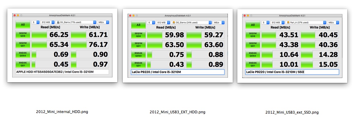

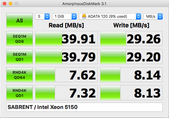

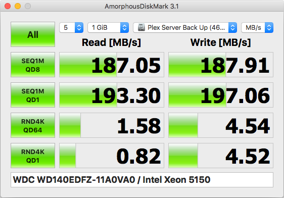

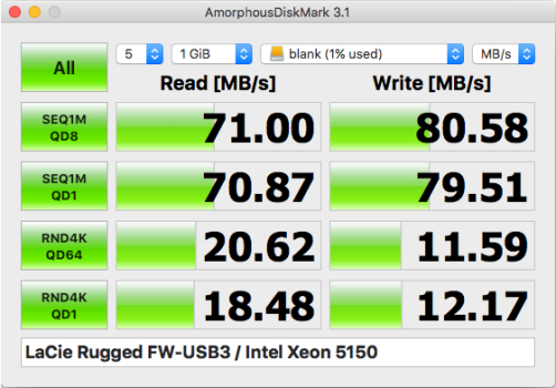

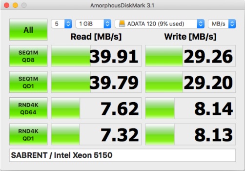

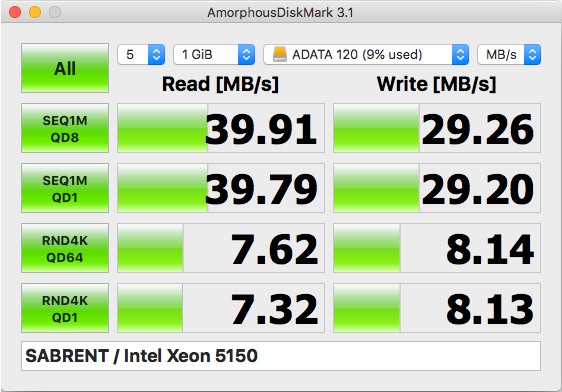

Test results w/ 2014 MBA & 2012 MacMini:
The USB3 SSD sequential speeds on the Mid 2012 Mac Mini is slow, like USB2 speeds.
I would check in the System Report and see what the link speed with that LaCie enclosure. Maybe it is linking at a slower speed with your Mac Mini. Maybe try another enclosure if you have one, or try a USB3/SATA adapter cable.
The upside of the results is that it clearly shows why SSDs are used in older Macs. Look at the random speed difference between the HDD and SSD.
Also, you might want to keep the test size the same for every test to keep things consistent, an "apples to apples" comparison. You have 1GB for the 2014, and 512MB for the 2012.

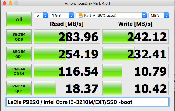

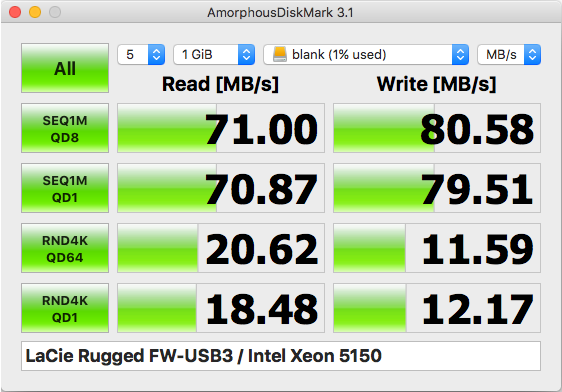

SysReport says SATA link 6 Gigabits, negotiated 3 Gigbits, under USB the LaCis says up to 5 GBps. Not sure where else to look.
However I just booted from the external SSD in the LaCie enclosure (USB3<>USB-a cable) and speeds were more like what I expected.
Yeah, that is a huge improvement, over 5 times faster when retesting it, and closer to what I would expect to a SATA SSD over USB3, but still a little low.
Maybe the SSD was indexing the first time you tested it, but that was a huge hit to the read and write speeds.
Wonder why it is negotiating it down to 3Gbps?
I looked it up, and the drive specs has it as a SATAIII. What SATA SSD are you using? Maybe it isn't playing nice with the LaCie enclosure.
Either way, it is a huge improvement over the HDD, and is you decide to install the SSD internally, this would improve sequential speeds as well have TRIM support once you enable it.
