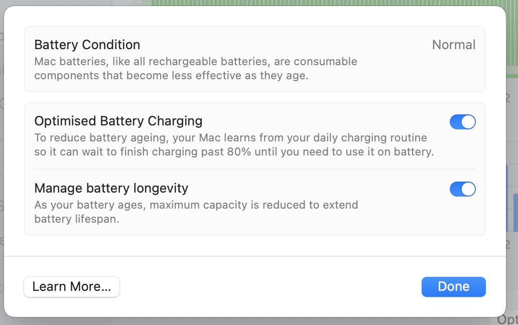

Check also System Settings > Login Items > disable and delete all 3rd party apps there, so no 3rd party app working in the background. Work with your MacBook on battery until the level is about 40%, shut it down and leave it for a while. Check also before shutting down, if the Optimised battery charging is enabled.
Let it be plugged in always, at least while you are using it near an electricity socket. If you have to use it on battery, use it all the way up to 40%, and then plug in again. While plugged in, check how your MBP acts sleeping with lid closed. When, you are working on battery, instead of put it to sleep, shut it down. Do that few times. After a while the MBP/macOS catches up and the heating would go away, and you'd be able to put it to sleep with lid closed without heating. (I've gone through this matter with Sequoia Beta on a 15" 2018 dual graphic MBP with success.)
The not working usb-c ports on the right side is troubling, which signals that it might have a logic board problem.
