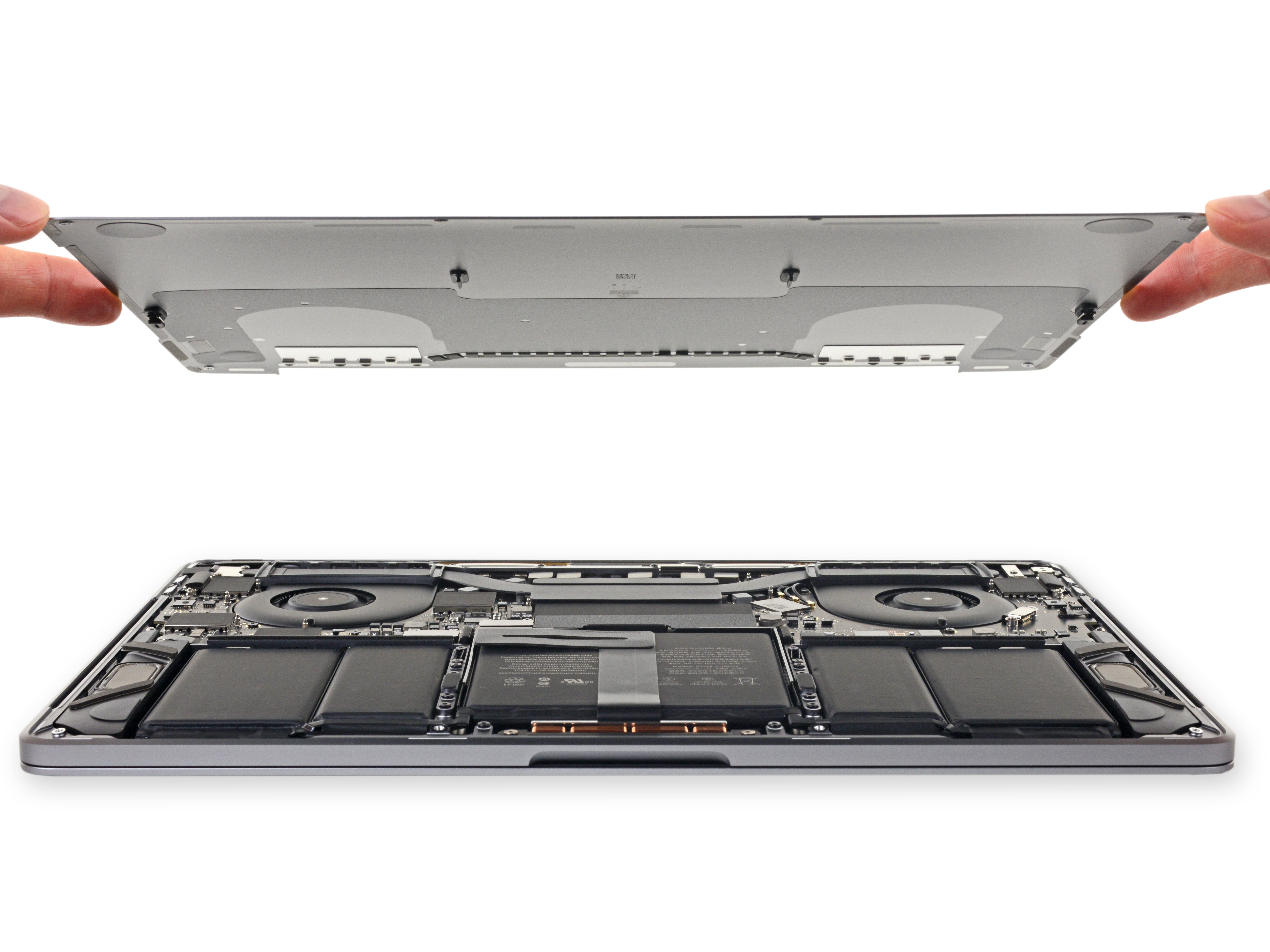

I would also probably try disconnecting the battery - you have to remove the bottom cover to get at the battery connector. There's an iFixit article that will show you how to do that.
Any 2019 MBPro uses pretty much the same steps to remove the bottom cover.
