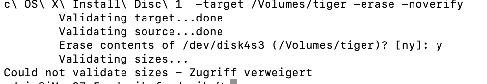

Okay the download took forever but now I have a 13 GB dmg file.
Unfortunately I cannot create a bootable drive.
I think this is why I ultimately used TransMac.
