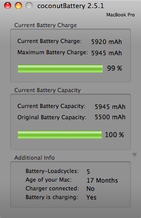

How about this one... 5 cycles after 17 months... but my favorite is
charger connected: no
battery charging: yes
how is that even freakin possible?!
i am just dumbfounded at the moment. can someone enlighten me to how they are doing this?
such low load cycles on an 8 month+ mac whilst at the same time the battery is charging while no charger is connected? hmmmm
coconutBattery must just like to mess with people like me :confused:
Coconut is not working properly on Leopard is what is happening. My load cycles are really 174.:rolleyes:
ahhhhhhhhh ok that makes a lot more sense :D
Yeah, Coconut has really been a disappointment. I loved it under Tiger, but it's unusable for a lot of users with Leopard. However, like I mentioned before, there is a work-around:
