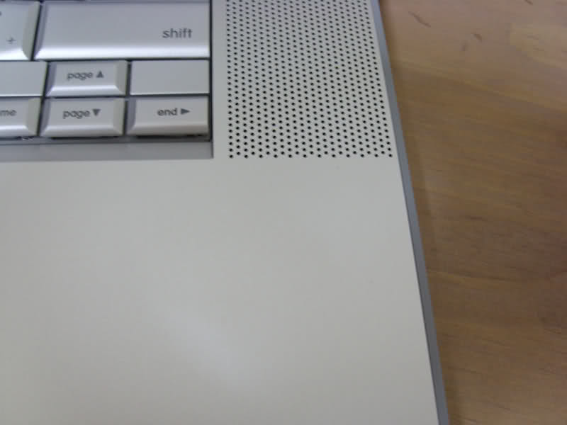

Today i was playing around with a magnet and sweeping it along the MBP(yes i know it is very dangerous for the components inside blablabla) and it suddenly went to sleep! i sweeped the area again, and it woke up!
that area is:
just below the grilles, at the right edge.
sweep it with a not too strong magnet and try it out.

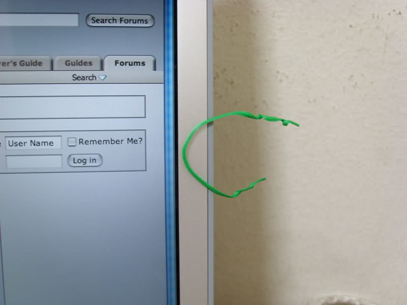

And i got a metal wire and put it on the screen, the part that will be closest to the sensitive spot when the lid is closed, and the wire is attracted to the screen.
So there is a magnet in the MBP screen.
So the sleep mechanism in the MBP lid closing is a magnetic switch, and not some sensor in the hinge.

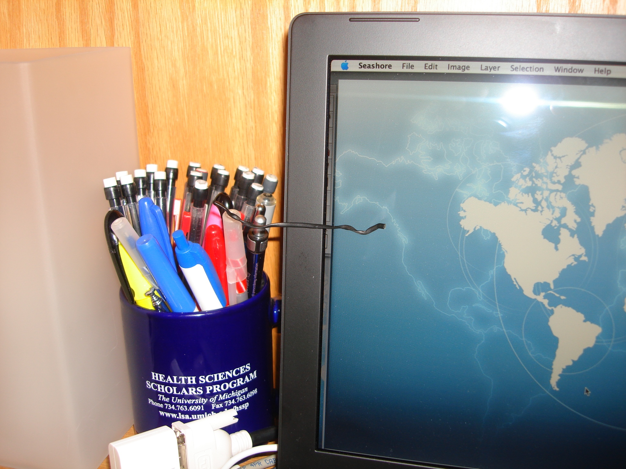

I would consider this worthy of a new thread... i don't think that many ppl are aware of this. Anyway, here's a picture of where the magnet is located on the macbook for anybody who doesn't want to find it on their own.

well, like i have said all other threads seem to say that there are lots of magnets(left side, top, right side) on the MB's screen, and can hold the remote, and that the MBP had NONE because its mechanical latch is enough, and thus it holds no remote.
This thread is just to prove there IS a magnet in the screen, though somehwat weaker than the MB's ones thats all.
