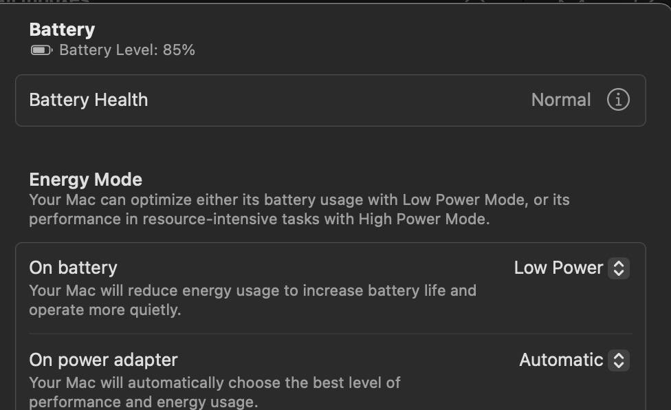

Go to Settings --> Battery -- and hit the (i) symbol on the top right next to Normal:

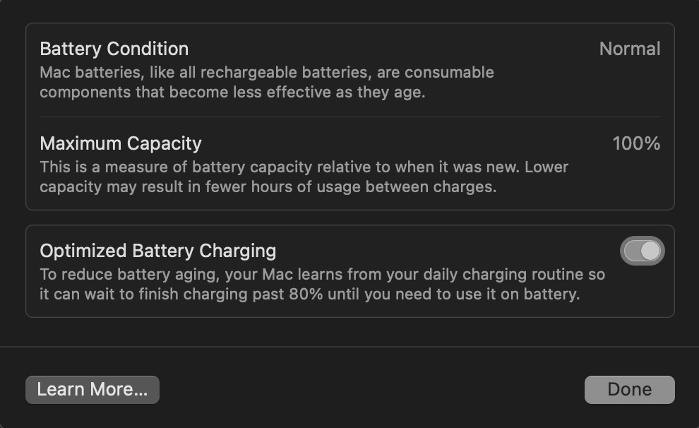

And you'll get this:
Here you can turn off Optimized Battery Charging if you so choose.
