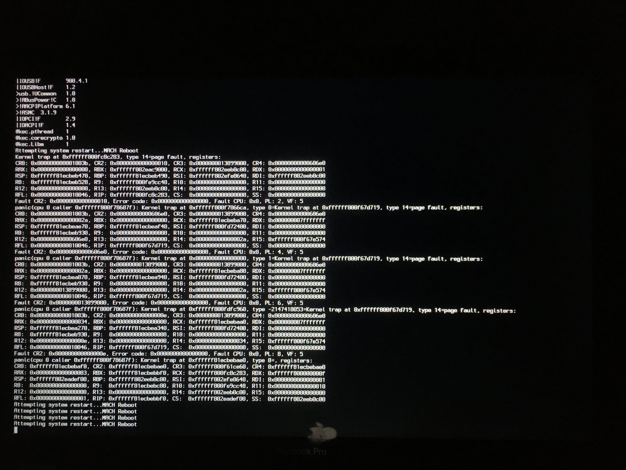

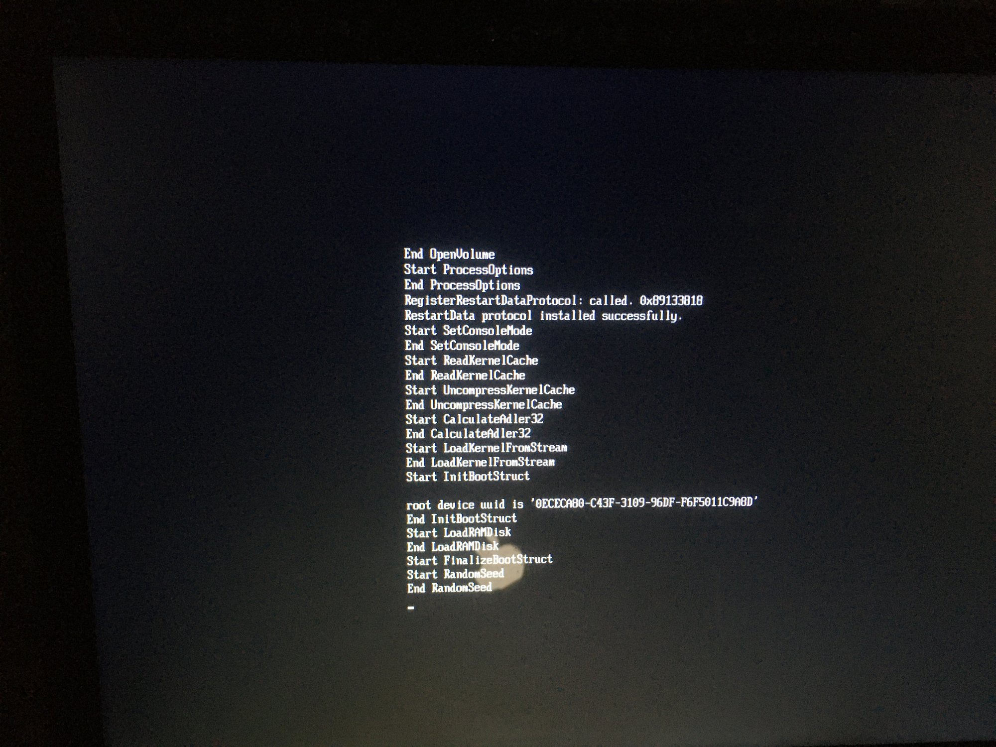

The thing now is, when I try to start the MacBook without pressing any special startup configuration, the screen in attachment 1 appears and ends with the screen in attachment 2. The same occurs when I try to use one of the following :
Trying Starting into >single user mode<
---> cmd + s
Trying Starting up in >verbose mode<, doesn't work at all
---> cmd + v
The shell is not usable in all three situations, so I can't type anything there.
What was working prior, somehow seems not accessible anymore...
Cause I could type into the shell previously performing the last steps of code in the tutorial...
_________________________________________________________________________________________
Starting up into >Recovery Mode< just works fine somehow, no graphics issues, no failures whatsoever, just works in a clean and unaltered manner. It just is there as it should be. -> it starts up with showing a bunch of code in the manner of the >single user recovery mode< , then shows me the language selection and its normal user interface.
---> cmd + r
Does anybody have a clue how I can maneuver myself out of this pity again ?
Its just mad, not having any way of movement that I can perform from my own minds capacities, as I just don't know what's happening...
Maybe you got a trick up your sleeve...
