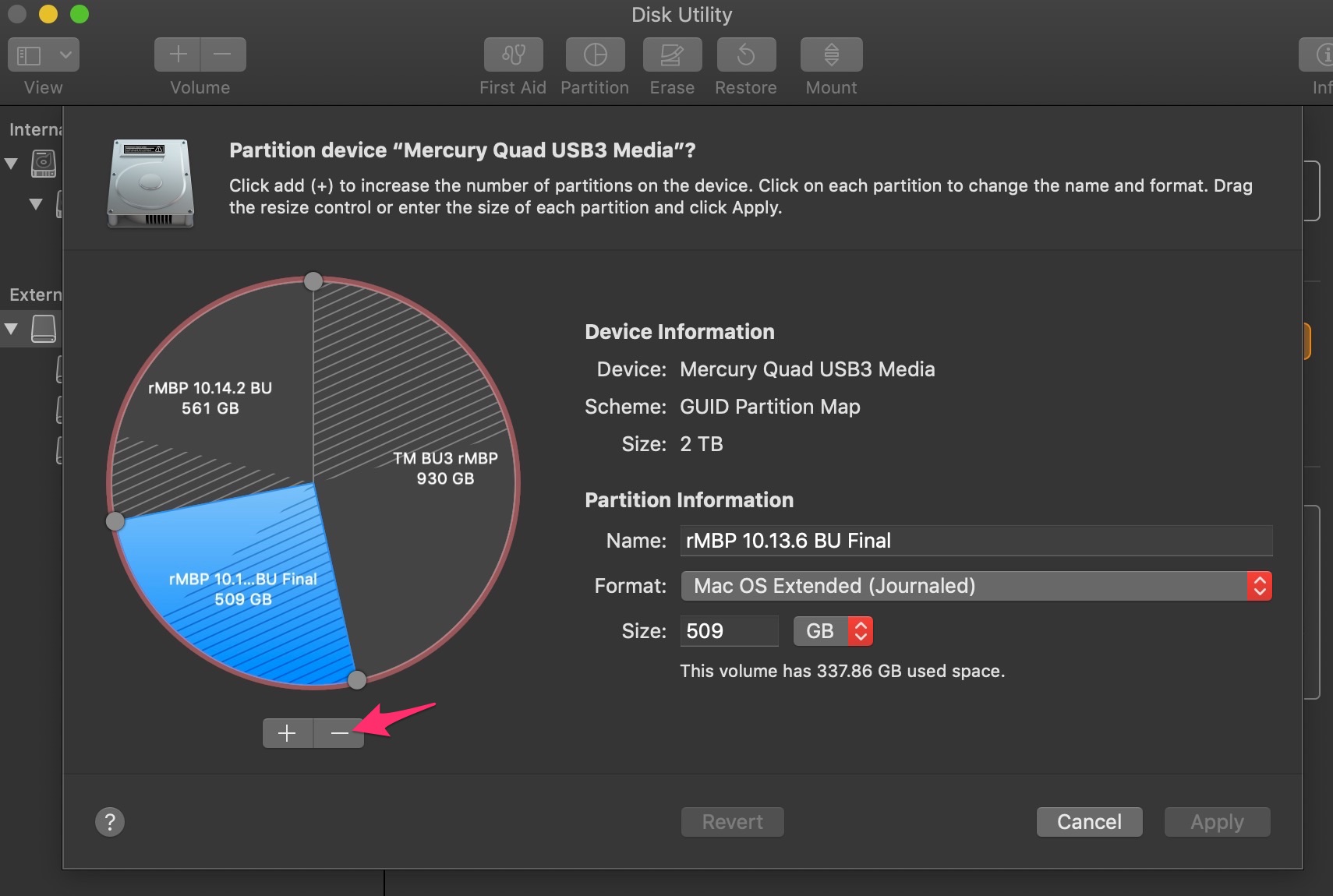

You could try backing up the data that you want to save on the Seagate, erase (format) the TM volume, then go to the partition graph in Disk Utility and click on the - button to see if it works for you. If it does not then you can go the brute force method. This method would work best if the TM partition is not the first volume.
