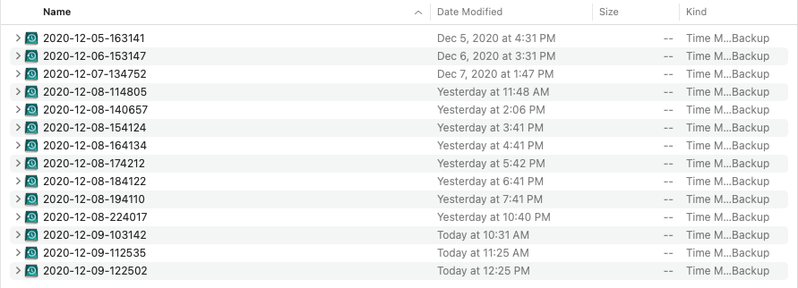

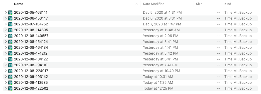

yes, this is the whole point of the thread - for HFS+ drives you can just move the .backups folder to the new drive. however when they are formatted as APFS, it won't let you move the backups over as they are not contained in a .backups folder. see the structure of an APFS time machine drive below. none of these are copyable/moveable:

also, i'd like to note that the only reason i formatted the external HDD as APFS over HFS is because my original backup drive was an SSD formatted as APFS (samsung T7 external ssd). i figured if i formatted this new drive as APFS i'd be able to migrate all the backups and just deal with it being APFS, but alas i cannot, which is why we're here!
