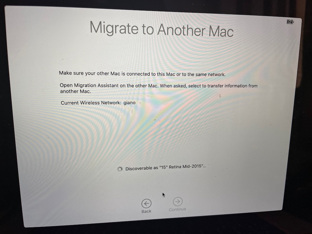

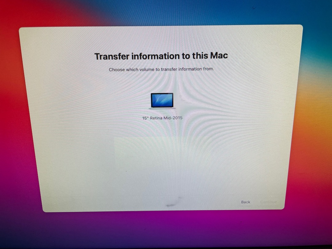

M1 Mini is not allowing any migration of data from my 2015 MBP.
I have a Time Machine backup on an external Thunderbolt SSD using an Apple TB3-TB2 adapter.
Fails on both the setup screen (before account creation) and after setup (using Migration Utility).
What am I doing wrong ??

I went through the migration process today. 2016 13" MacBook Pro to M1 MacBook Air. Here are the challenges I faced with tips to overcome them. Hopefully will be useful and save time for others.
Problem 1: During the set up process of my Air I said I wanted to migrate data from another Mac. This opened the migration assistant. MacBook Pro which I was migrating from was at 11.0.1. The migration assistant on the M1 Air began update to 11.0.1 on the Air. The update ALWAYS failed. I tried two wifi networks and of course restarted the air etc. Tried maybe 5 times.
Solution: During the set up process of my MacBook Air I said I was not transferring data from another Mac. I just went through and set it up as new. Once I had my profile set up I went into software updates without and updated to 11.0.1 without issue and then returned to the Migration Assistant for a new problem.
Problem 2: After opening migration assistant and connecting both Macs together via USB-C, I opened the migration assistant on my old MacBook Pro and began the migration process. The Macs would only connect via wifi peer-to-peer. I then realized after research that I needed a thunderbolt cable to connect the two Macs so this problem was my fault.
Solution: Purchase an Apple Thunderbolt cable.
Problem 3: Both Macs connected with the correct Thunderbolt cable which should allow for data transfer via the cable (much faster than wifi). I opened both migration assistants but they were still ONLY connecting via WiFi. No option available to connect via thunderbolt.
Solution: Call Apple support who was equally surprised at the situation and after some research on their part they said I would need to put the MacBook Pro in target disk mode. Open system preferences and select start up disk then restart in target disk mode on MacBook Pro. Then with both computers connected with thunderbolt cable open migration assistant on MacBook Air and begin transfer.
Yes, this was the case with me as well - very irritating that the initial M1 setup screen says it can take a Time Machine or another Mac to transfer - wirelessly or wired network = no go.
Finally had to connect via TB cable and TB3-TB2 adapter in target disk mode order to migrate the data over.
