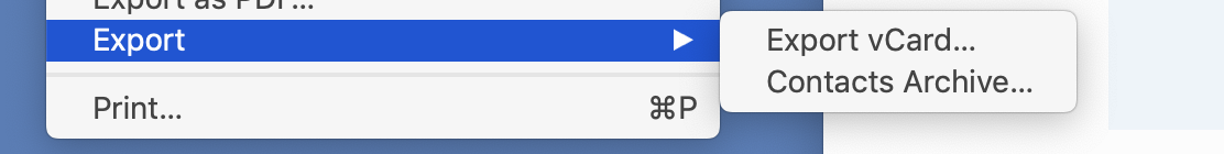

This is a Mojave Contacts screenshot, but I believe the old version on your eMac will be similar. In the export menu, make sure you export as VCARD and not the other archive option. Then you should be able to merge/import the vcard file on the new Mac.
I did manage to find that. Oddly enough though, after doing so, the "My card" on the Mac Mini was changed to a random contact info and also none of the groups that were setup on the eMac transferred over. Other than those 2 things, it seems to be ok.
