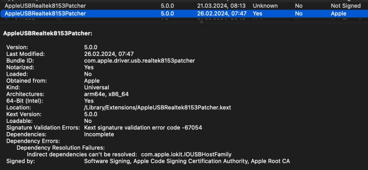

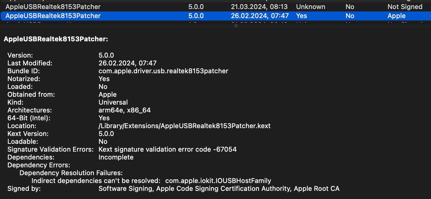

While I could take AppleUSBRealtek8153Patcher.kext from Monterey Intel and install it in Sonoma 14.4.1 Apple Silicon, it can’t be loaded as dependencies are missing.
“Dependency Resolution Failures:
Indirect dependencies can't be resolved: com.apple.iokit.IOUSBHostFamily”

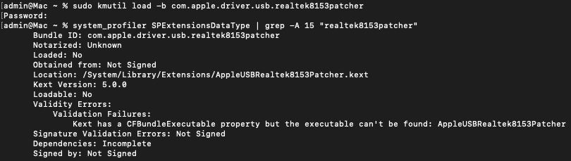

Have you tried loading it by reference to bundle identifier instead of the bundle path?
Code:
sudo kmutil load -b com.apple.driver.usb.realtek8153patcher
Are we now going to pretend that every dumb thing Apple does is “as it should be”? Apple set the rules for software signing and notarization. It should respect them. If Apple doesn’t want to continue to provide support for some hardware on Apple silicon, Apple should remove the kext, not leave a broken one in the system volume. It’s not rocket science, it’s basic logic :)
The kexts are still present, the Mach-O executables/binaries are elsewhere, compiled into a "kext collection". I suppose the kext bundles themselves are still necessary for the corresponding loaded kexts in the kext collection.

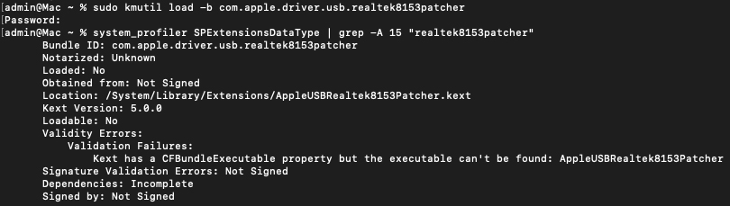

Code:
"Bundle ID: com.apple.driver.usb.realtek8153patcher
Notarized: Unknown
Loaded: No
Obtained from: Not Signed
Location: /System/Library/Extensions/AppleUSBRealtek8153Patcher.kext
Kext Version: 5.0.0
Loadable: No
Validity Errors:
Validation Failures:
Kext has a CFBundleExecutable property but the executable can't be found: AppleUSBRealtek8153Patcher
Signature Validation Errors: Not Signed
Dependencies: Incomplete
Signed by: Not Signed"
