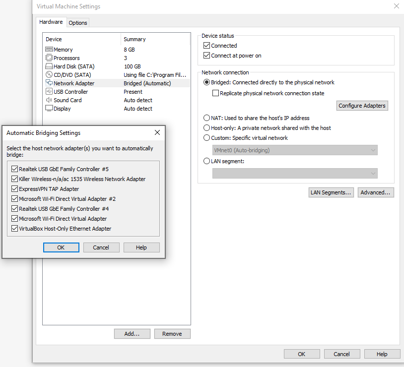

I went into virtual machine settings, network adapter - it was set to NAT. I changed it to bridged - was told: you are not connected to the internet. Went back to network adapter and looked at configure adapters. One of 7 was checked - microsoft wi-fi #2. Checked two more that I thought might be applicable. Now it tells me: safari can't find the server. Returned to configure adapters, checked them all. Repeats: safari can't find the server. Tried a couple URL's that I know are good.
I'm attaching a screen capture of the settings so you can see how the adapters are listed.

Thanks for your assistance, barbu. I do not really understand - the first successful installation of VMware player and macOS did not require me to do anything with the network settings.
I'm attaching a screen capture of the settings so you can see how the adapters are listed. View attachment 1899568
helpful screenshots. So on your windows machine, you are connecting via wifi right?
So in the adapter settings shown, you *only* want to select the adapter that your windows machine uses to connect. So I think in this case, that would be the “killer” one. Deselect all other adapters and save.

Well, my main connection on my windows laptop is actually a wired LAN connection through a USB 3 adapter. But I of course have wi-fi too, and yes that connects with the killer adapter. After I checked all 7, I actually had both the wired LAN and wifi connected.
So you’ll want to select the wired connection, and only the wired connection. It should just work once this is set correctly.

I unchecked all LAN interfaces, except the #5, which is the hard wired LAN connection through a USB port:
Realtek USB GbE Family Controller #5 (USB 10/100/1000 LAN)
But, even though system preferences/ network within Catalina shows all normal, I still cannot access the internet.
