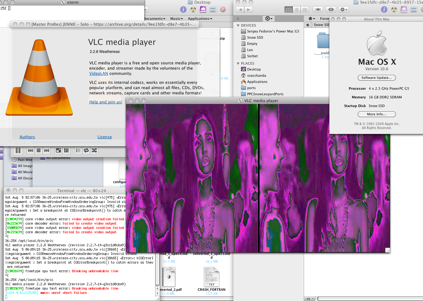

To illustrate what I mean re X11, this is supposed to be a normal music video:
There are some chances that what is broken is the new Mesa and/or x11. Then rebuilding against the old ones may help. I will try it.
