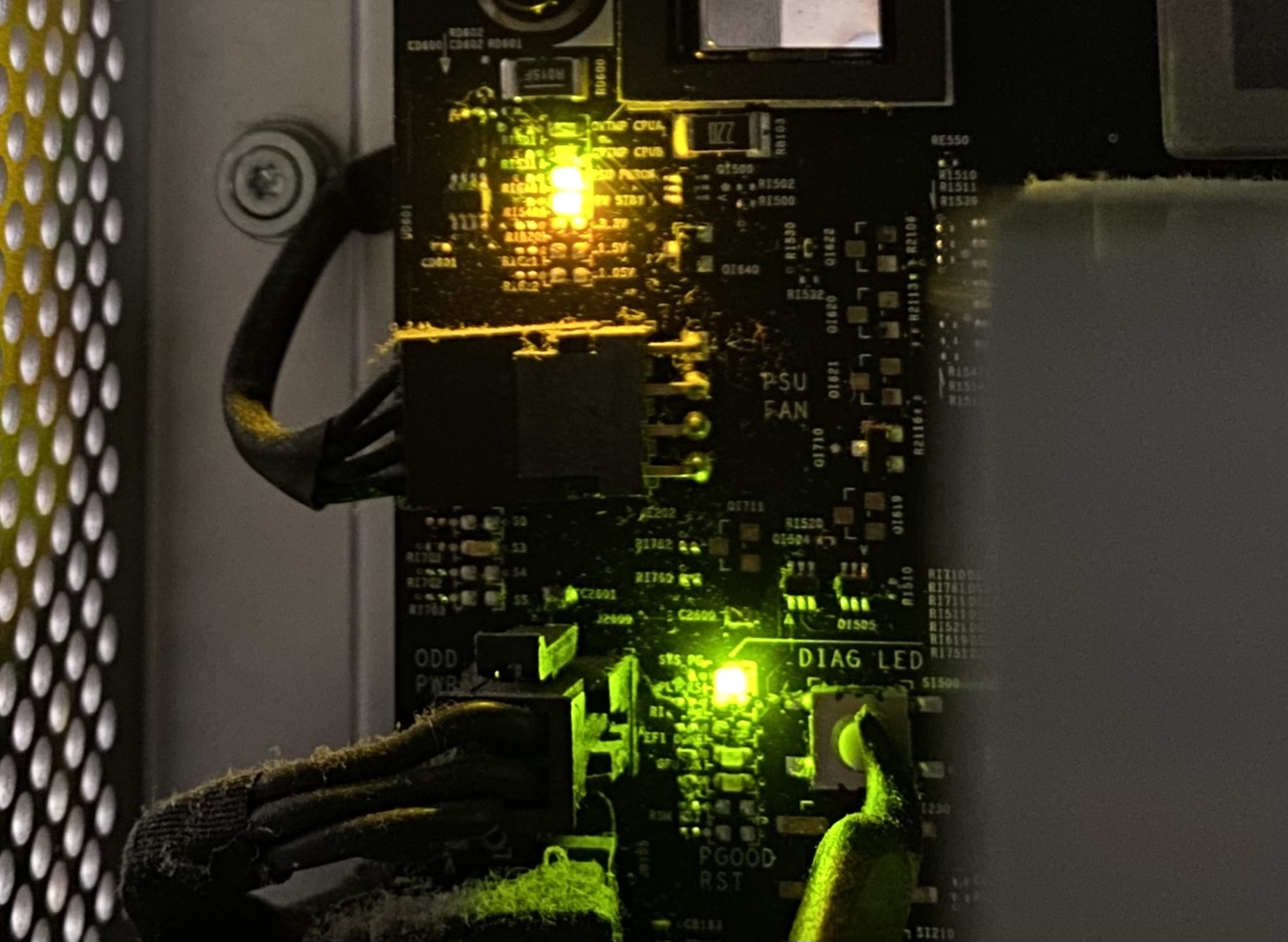

I have a 2010 cMP 5,1 basic quadcore cpu, in Mojave with a Sapphire Pulse RX580 8gb GPU. I have kept it mostly up to date, but it only had the 140.0.0.0.0 firmware. I recently ran the 2020-006 update and it seems to have bricked my machine. When it restarted, both monitors were black and have never come back. I let it run for about 5 hours, leaving and coming back to the same situation. I have tried everything I can think of to get it back.
I tried the original GT120 GPU to see if i could see anything as it booted, and so far no luck. Though when i still had the RX580 in, the monitor attached to that eventually turned half dark gray half light gray, and then fully light gray and then stayed like that until i unplugged it. I have also tried the long press on the power button until i get the beep and chime.
I have since pulled everything (optical drive, boot ssd, extra hdd, both gpus, all but 1 RAM stick).
When it boots, I get a chime and the power button is solid. When I press the diag button i get:
PWROK - GREEN
5V STBY - AMBER
SYS PG - GREEN
And that's it:
With no EFI DONE, am I at the end of the line with this backplane? Any thoughts on next moves?

Attach an USB Keyboard to the front or back ports
hold cmd-alt-p-r alltogether until the box chimes 4 times
if you are in luck and the 1st reset cleans enough of the nvram Streams.
maybe hold the keys some minutes, find a comfortable position.
if it comes back to life make a rom dump as soon as possible. Google dosdude1 romtool for it.
Then ask tsialex for cleaning the firmware.

Thank you! I forgot to mention that I did try the PRAM reset a few times, but never got more than the 1 regular boot chime. I will try it again, though! Should i put everything back in? boot ssd, gpu, etc.
try to get the 2nd and 3rd chime, even put something on the keys to hold them forever.
if that wont help theres the option to solder a fresh flash chip in programmed with the generic mp51.fd file of the mojave installer. But dump the old chip to get the hardware codes like sn, son, etc etc.
makes the effort to reconstruct much easier.
all in case the flash chip is the culprit.

I dumped my rom before and after the Mojave 2020-007 Security Update
one XML File was added in the 1st VSS Stream:

so, if the nvram is almost full a Security Update what writes a XML Log file into NVram could brick a Mac Pro 5.1 Efi
as I and others keep on telling: always make sure you have a firmware backup.
And it is always good to have a cleaned up firmware. Tsialex can do this. Only in case he is way too busy I can do it, too.

I can't thank you enough! I switched to a different keyboard (classic full mac keyboard) and got the PRAM reset to work properly! I waited 4 times, and now i am back in! I disabled SIP and made a dump of my ROM for backup (And even got the first step of opencore done in the process ;) ). Thank you so much!!
