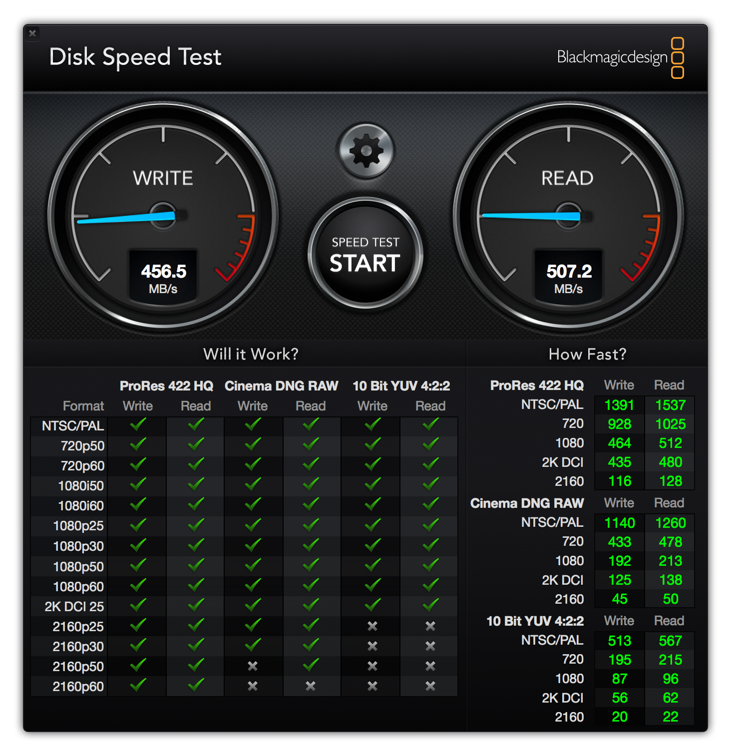

For disk performance, BlackMagic make a very good tool
This is just from a SATA III connected 840 Evo. Even for ProRes 422 HQ (which is more demanding than normal ProRes 422), 507MB/s is good enough for up to 128 FPS.
But if we want to edit 2160P 10Bit YUV 4:2:2, then only 22 FPS.
For H264 or HEVC, disk speed really doesn't matter, the data rate is so low, even real time internet streaming is possible. Any modern HDD can do that (I really mean HDD, not SSD).
