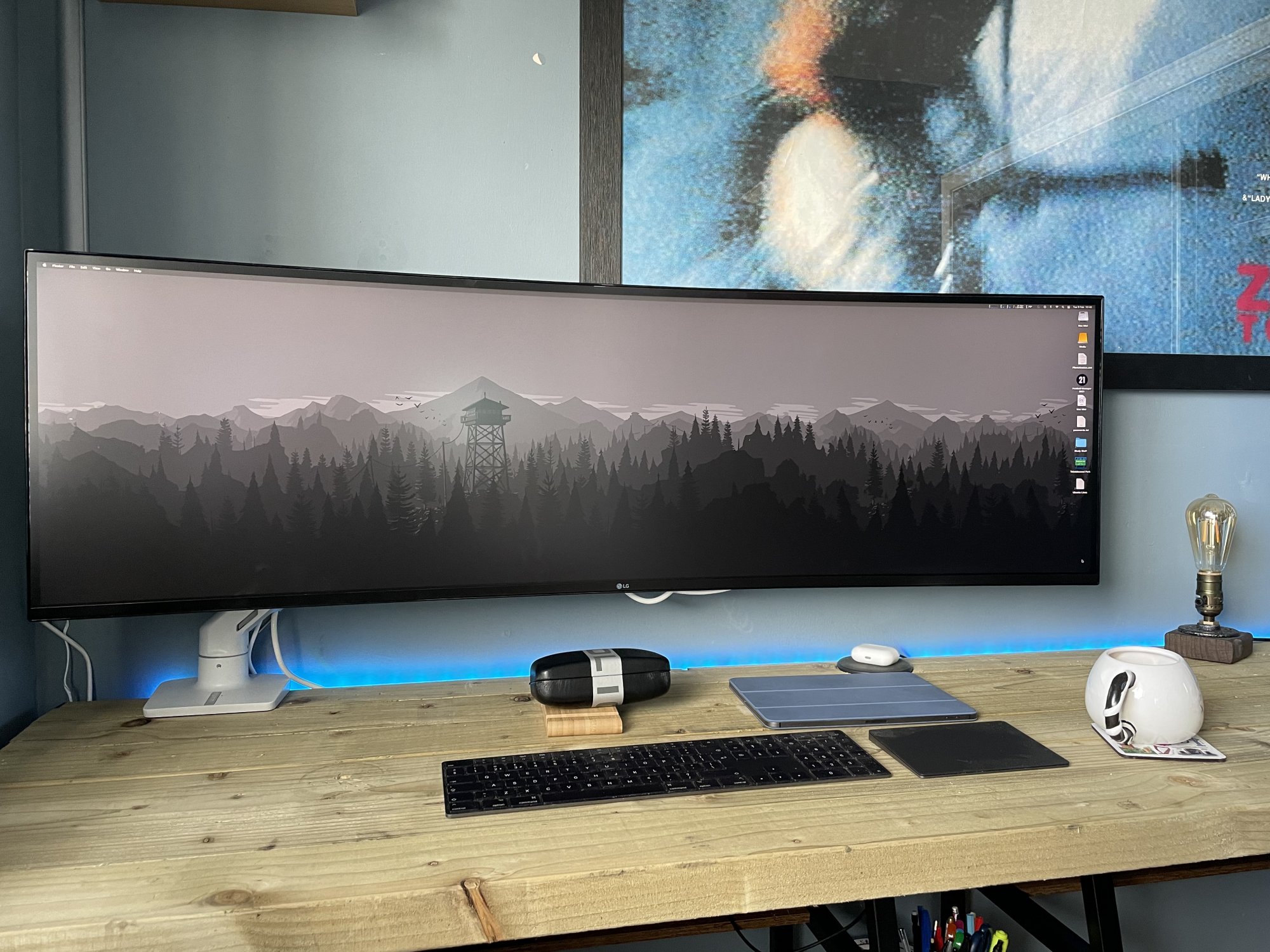

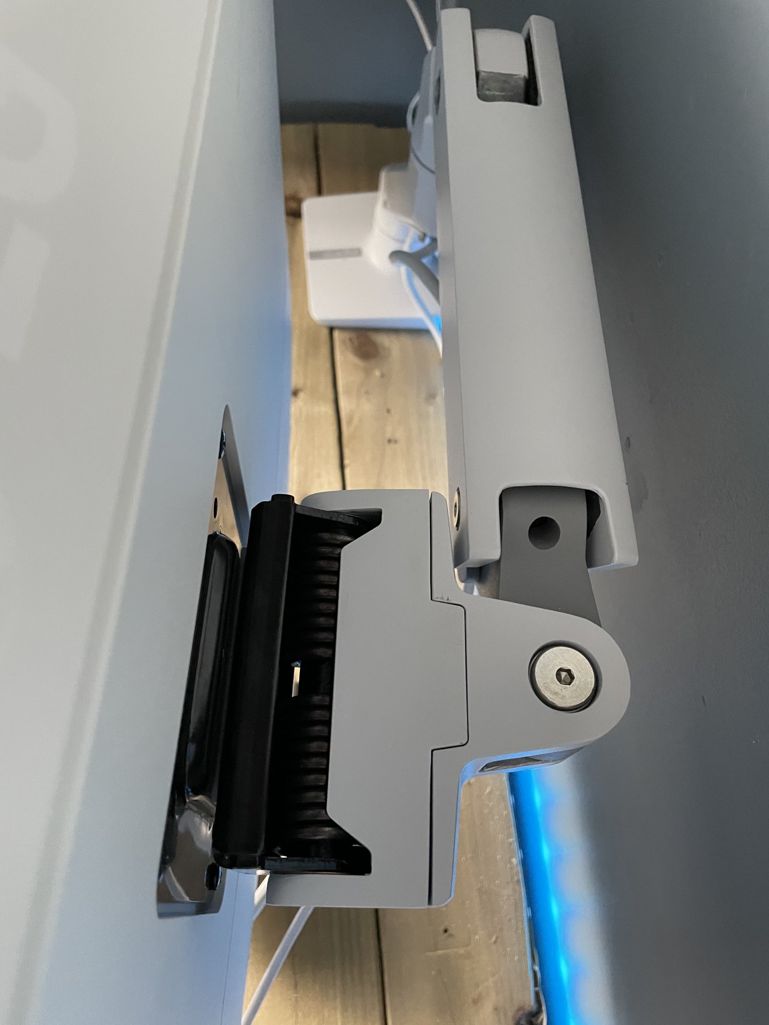

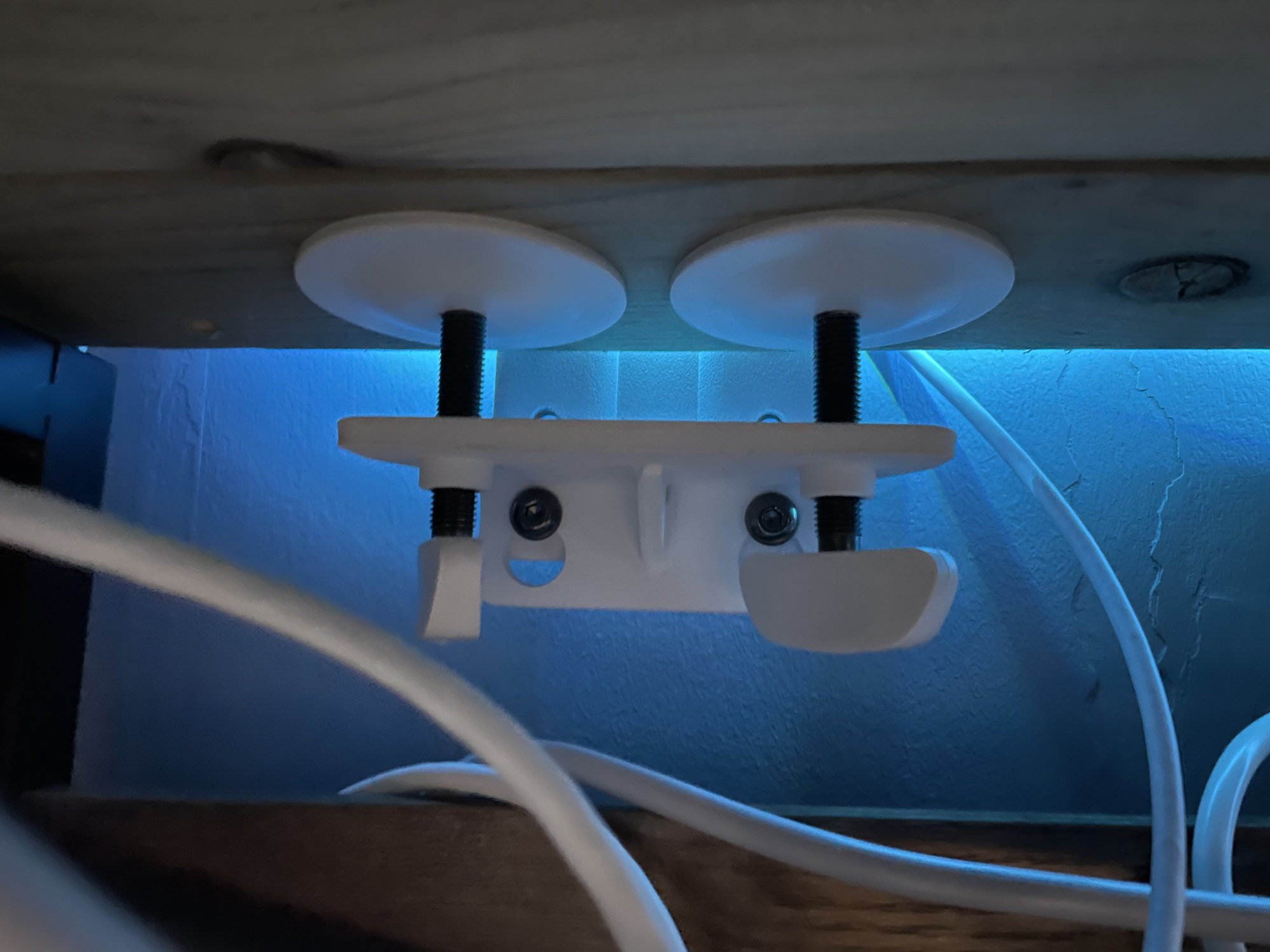

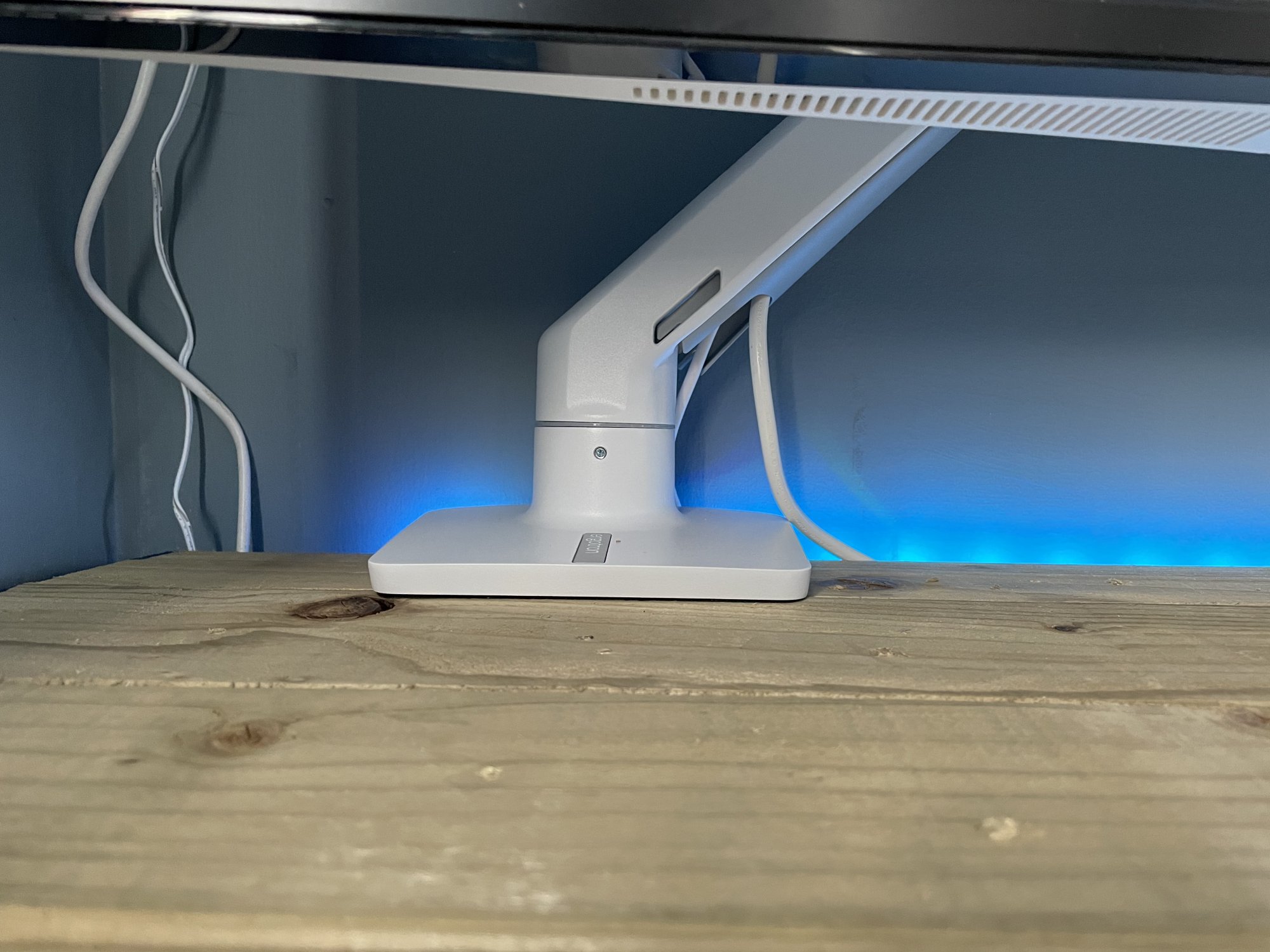

I've got a 49" LG Ultrawide with the Ergotron HX arm. Its a solid piece of kit which is rated for this size & weight of screen - highly recommend it.
It does free up a good bit of desk space compared to having it on the original stand.

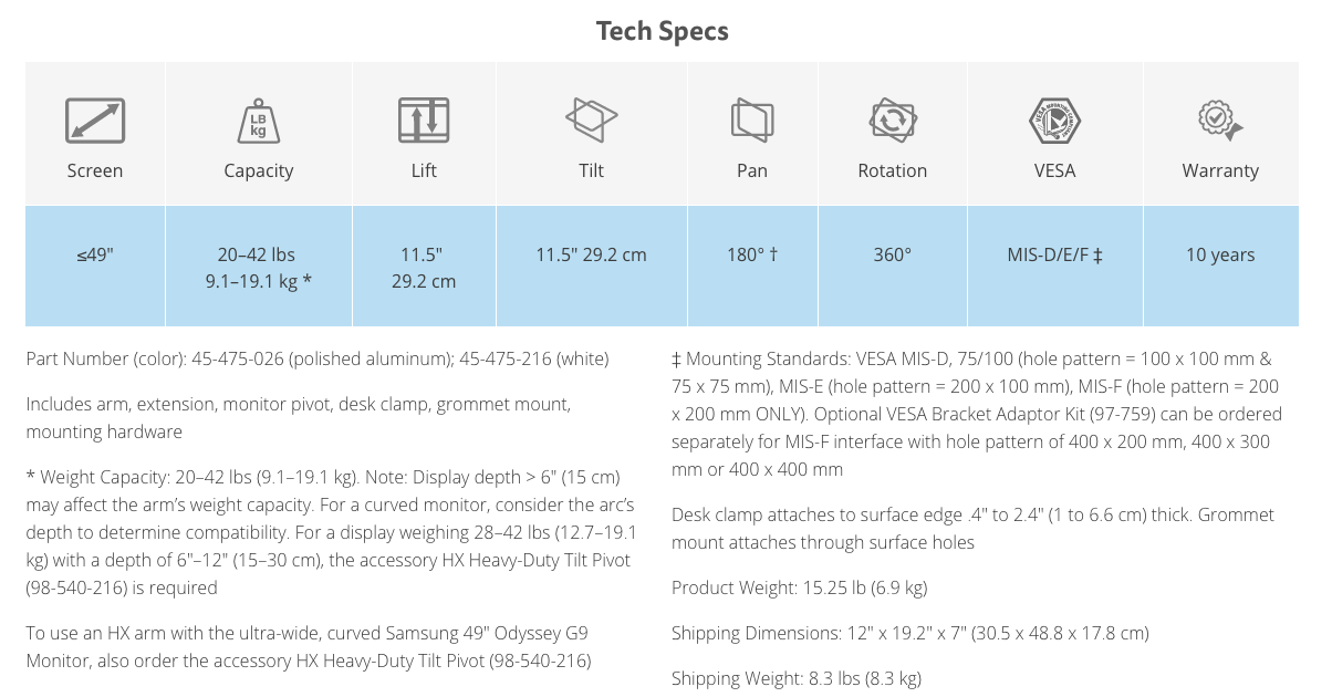

I think the Ergotrons desk-mounts only go up to 42 lbs. They have a TV wall-mount one for up to 70 lbs…if your wall construction can handle it.
looks like it can handle the 49" but not the weight. need Tilt Pivot also.

Unbelievable the weight difference between the LG and the Dell 49". The ARM is perfect for the LG but the Dell looks to be almost 30 lbs heavier. was not expecting that! Thx for the pics, nice setup.
30lbs heavier!? 😮
I should have read your first post properly, sorry!
That Dell weight is with stand. Without its 25.1lbs/11.4kg so is fine for the HX. Some have even said it works with the LX as well.
