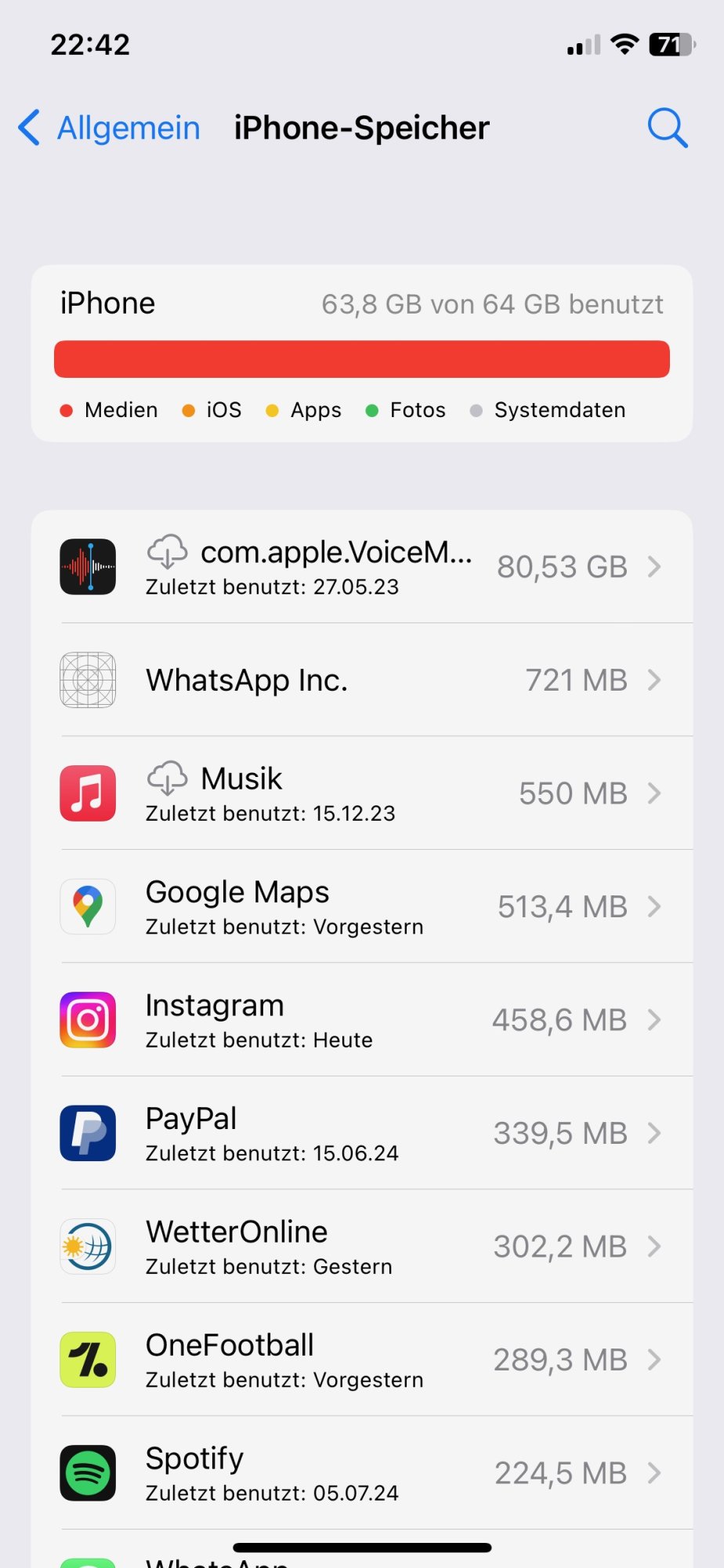

My brother's Xs (64GB) ist more than full. It is very strange, he sent me a screenshot shwowing over 80GB of Voice Messages on it even though they seem to be in the cloud and the bar had been completely red for Media. I just attached a picture at the bottom of this message. I don't even believe he ever produced that many GB of voice messages, but who knows... He used it much for a while.

P.S.: This is how his phone storage looked like, a few days ago, when he first told me about the problem.
Now that I see it again I recognized that there is this WhatsApp Inc. stuff on top and you can see there is also the app itself at the end of the list. Does anyone know what the upper one is? Maybe backup data?
But I think can research this for myself. Just wondered because I didn't recognize the second WhatsApp before.

But that list still is looking strange, shouldn't it show only the storage the apps are using on the phone? Maybe he deleted or offloaded the Voice Message App but not the Messages in it if this is possible.
If the phone storage is completely full - then Spotlight has quit indexing so you can’t count on that list (or the sizes shown in it) to be accurate.
Full device = “delete something,” anything, until it’s got enough free space (say, 3GB) for Spotlight to work. Until then, you have no guidance you can count on.

The ones with a cloud icon beside them seems to be already stored on iCloud...
Better confirm by logging in to iCloud.com
Based on the screenshot, Instagram and Spotify can be deleted to clear additional storage, provided that the username and password are both known... They can be downloaded again once there is enough free space...
Also, what is the size of stored photos and videos?
Reactions: Adora
@FreakinEurekan
@winxmac
I think he already deleted almost anything. Videos and Photos are all in iCloud. There isn't much more installed than seen on that list. Just a few small Apps.
When I see that cloud icon for an App it always only has a size of a few KB, so I don't think that Voice Messages and Music really take any relevant space.
