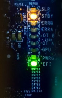

System diagnostic lights:
EFI light stuck on green, Power trickle light on yellow. (Image attached shows how it looks but it isn’t my image)
I’m thinking it could be the logic board that failed but I can’t afford to replace anything. I’ve tried every single troubleshooting and tried swapping the parts out except for the logic board. It’s also worth mentioning that all of his ram slots were filled with 2GB sticks running at 667MHz totaling 16GB, while I had one tray filled with 4x2GB at 667MHz, while the other tray had 2x4GB sticks (don’t remember the speed).
