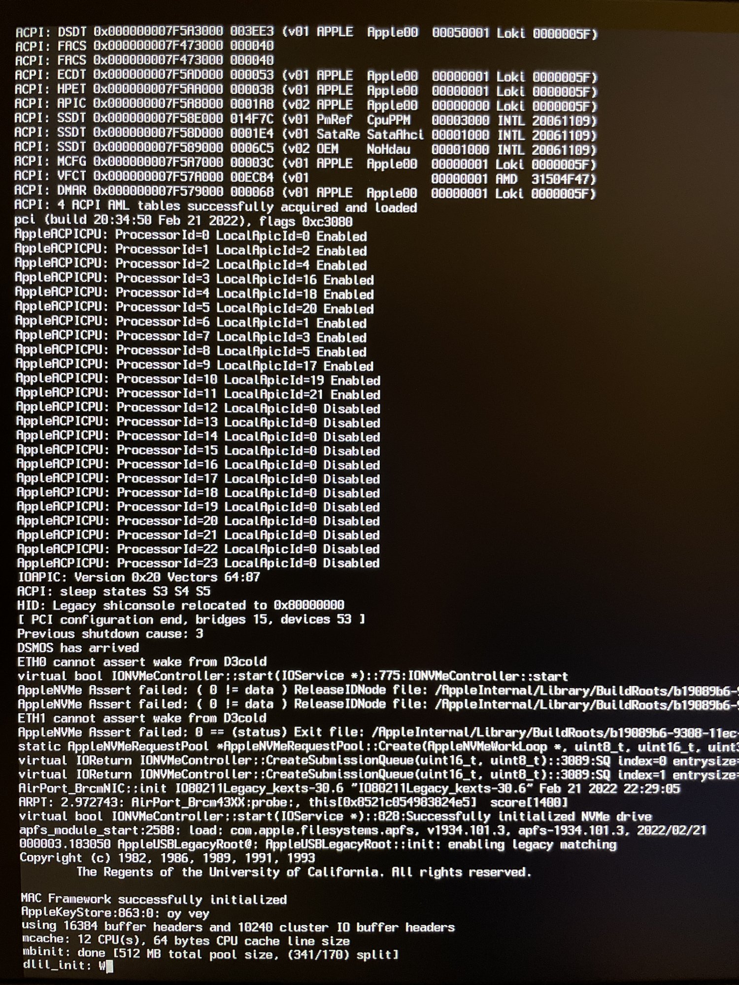

OCLP 0.4.3 and Monterey OtA 12.3.1 update ran and rebooted the machine. After that, boot screen shows, progress bar gets to about 50% and stops. Hard powered off. Powered on again, startup chime, but nothing on screen. Hard powered off. Powered on again, progress bar to 50%, let it sit for about an hour. Powered off, removed all drives except PCIe NVMe housing Monterey 12.3.1. What should I do next?
So it appears to be a “Apple NVMe Assert failed” error upon boot. 12.3 has been working fine on my PCIe NVMe. It has only become an issue as part of the 12.3.1 installation process.
Samsung 970 EVO 1 TB SSD.
View attachment 1987086So it appears to be a “Apple NVMe Assert failed” error upon boot. 12.3 has been working fine on my PCIe NVMe. It has only become an issue as part of the 12.3.1 installation process.
Did you tried enabling VMM and experimenting with SetApfsTrimTimeout?
970 EVO should use 4294967295, since is one of the drives that constantly fail to complete the TRIM process before the 10s standard timeout.

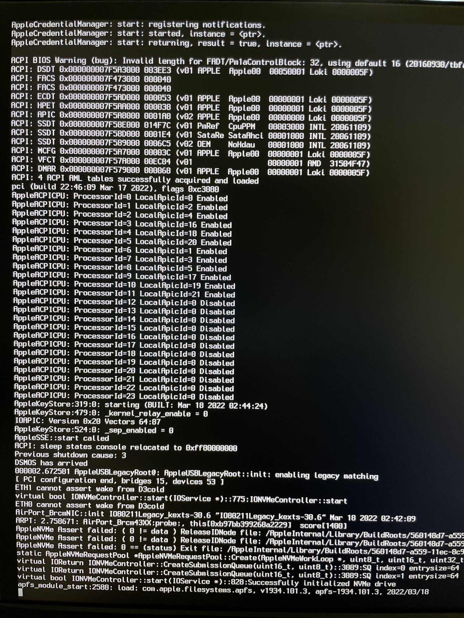

So I turned off the VMM flag - kept the TRIM timeout - turned off the machine, removed the Mojave drive, turned on, reset the NVRAM (3 chimes), and the installation finished! I am now running 12.3.1! Thanks again for your amazing help Alex! You’re the man!!
