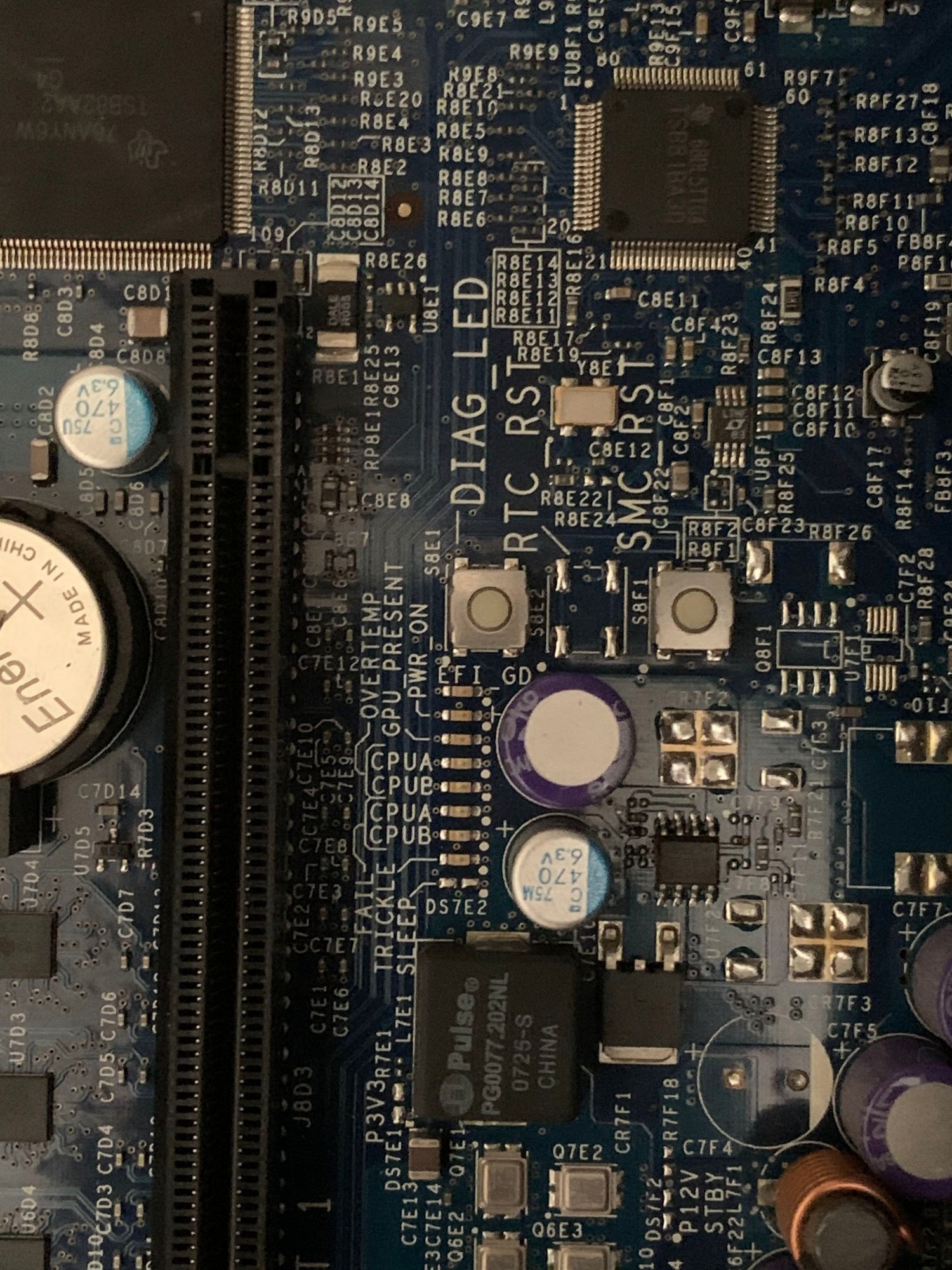

I can’t help really you but what is the state of the diagnostic LEDs on the logic board?
Is 2008 the 1,1 model? I have one of those briefly and found it very finicky after doing almost those exact upgrade. I did the Xeons, the video card, and ordered ECC ram from the bay. I had so much trouble mixing and matching the Ram chips and slots to get it to run properly.
anyway, all that to say these machines can be divas. Post your led status and someone should be able to help.
[automerge]1591493169[/automerge]
Oh and did you do a CUDA reset?

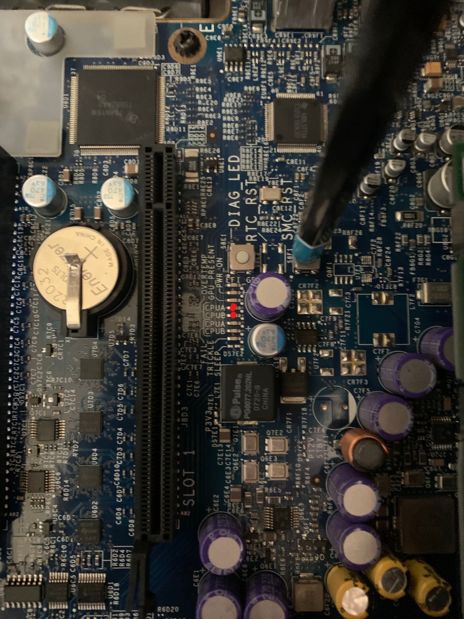

Yeah i think is the 1,1 model. The label on the rear part of the case says "A1186 - EMC 2113", i looked in everymac and it's the 2008 Mac Pro ID1,1. For LEDs do you mean the one under the PCIe slot of the GPU? (look in the pic). Those leds does turn on only when i connect the AC cord into the Mac, they turn on for half a second (only the first two CPU A and CPU B leds) then i click on the power button and the fans starts spinning super fast with no chime. No LEDs does turn on when i click on the power button after connecting the AC cord. The other way they turn on is when (with the Mac on) i click on the little button near the leds that says "SMC RST" (look the second pic). When i click that button again the two upper CPU A and B leds does turn on for half a second and the machine shuts down. I don't know if it could be helpful for you. Also: I have no idea of what's a CUDA reset 😅

I have the same problem. I got my Mac Pro 1,1 for free and I don't know how to fix this issue. The Diagnostic LEDs are displayed in the same way as the user @TheMatx18 showed.
I tried anything: changing RAM, changing GPU port, unplugged and plugged every cable on MOBO... still the same issue.
