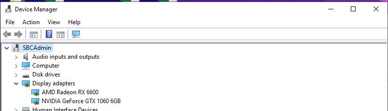

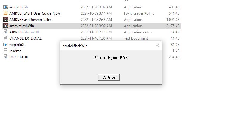

I tried and it did not work,
the PC shows 2 graphic cards in the device manager but can get the amdvbflash run, saying "Error reading from ROM" (driver installed)

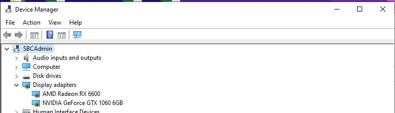

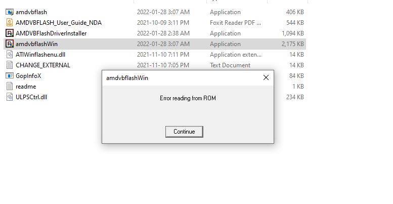

You may need to force flash a bricked card in order to recover it. DOS prompt (as admin) usually works better. In fact, if possible, use Linux.
If that still doesn't work, you may need to short some pins before you use amdvbflash.
And your last resort is to buy a hardware flasher to flash your 6600.
