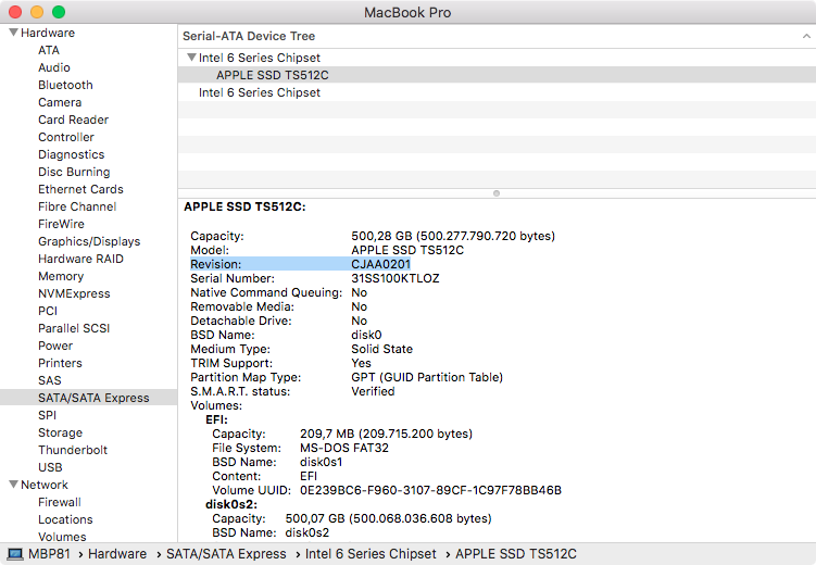

You can check if the firmware is the current one, it's the Revision below:
Oh! The disc is an 860 QVO 1TB if that makes a difference? It is : Revision: RVQ01B6Q
Samsung QVO drives are not compatible with MP5,1, change it to EVO or PRO drives.
