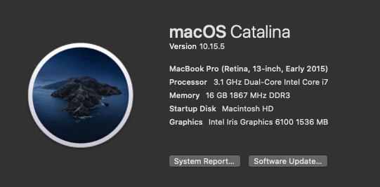

Hi,
I have an Early 2015 13" MBP Retina and I cannot get 4K @60fps streaming on YouTube within the most up-to-date versions of Google Chrome or FireFox without almost all frames being dropped. The external monitor that I am using is a Dell U2720Q, and the specs for my MBP are attached in the image immediately below. I have an internet download speed of 300+ Mbps.
From my research thus far, it seems like my MBP should be capable of driving 4K @60FPS, and it seems like this works on websites like Vimeo, but I cannot seem to figure out how to get it to function on YouTube.

Vimeo uses H.264 codec while YouTube uses VP9. Your 2015 13" MBP has Broadwell Intel chip, which has hardware decoding support for H.264 but not VP9. When you play YouTube videos, it's software decoded on the CPU and is very intensive for a regular 4K video, let alone a 4K 60 FPS video.
