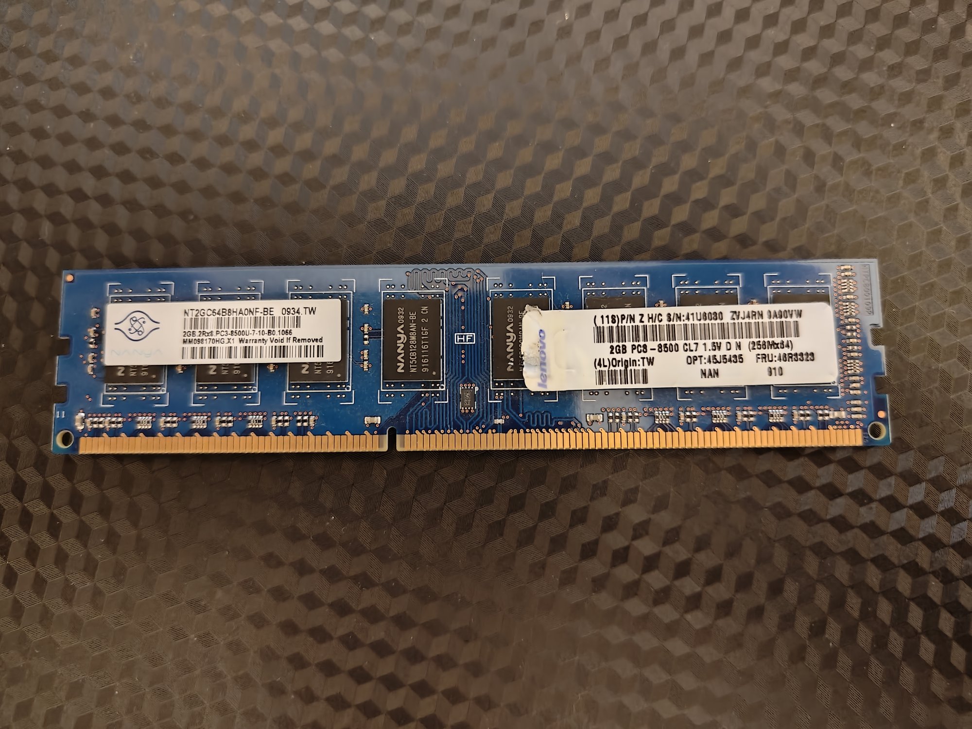

So I got an old Mac pro 2009 for free, but it was missing ram, a hard drive, and a GPU. So I bought some ram that fit the specification on Apple's website (see pictures) and then I bought a used MSI rx580 armor 8gb oc. (I've tested it in a windows system, it works perfectly) I also bought a 6 pin to 8 pin power adapter off Amazon. I put that all together and... Black screen. I hear the Mac bootup chime coming from the internal speaker, but nothing on display. I fear that it has something to do with the GPU or maybe even the power cable since I have noticed some people talking about using a dual 6 pin to 8 pin adapter for their rx580. Anybody got any ideas?

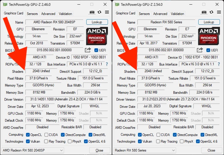

Did you verified if the RX 580 is not a model unsupported by macOS with just 2048SPs, these are RX 570 GPUs that were factory flashed for the Chinese market and Apple AMD drivers doesn't support it:
Install your RX 580 to a PC, open GPU-Z and check the Shaders value, if there are 2048 or 2304 SPs.
AliExpress is selling the incompatible GPUs everywhere and these 2048SPs models doesn't work with macOS.

If your RX 580 is a 2304SPs and your harddisk does not have a working macOS release after 10.12.6 (first macOS release that have drivers for a RX 580) you won't see a display working.
You will need to borrow an AppleOEM GPU and install 10.12.6 and later macOS releases to get the RX 580 with a working display.

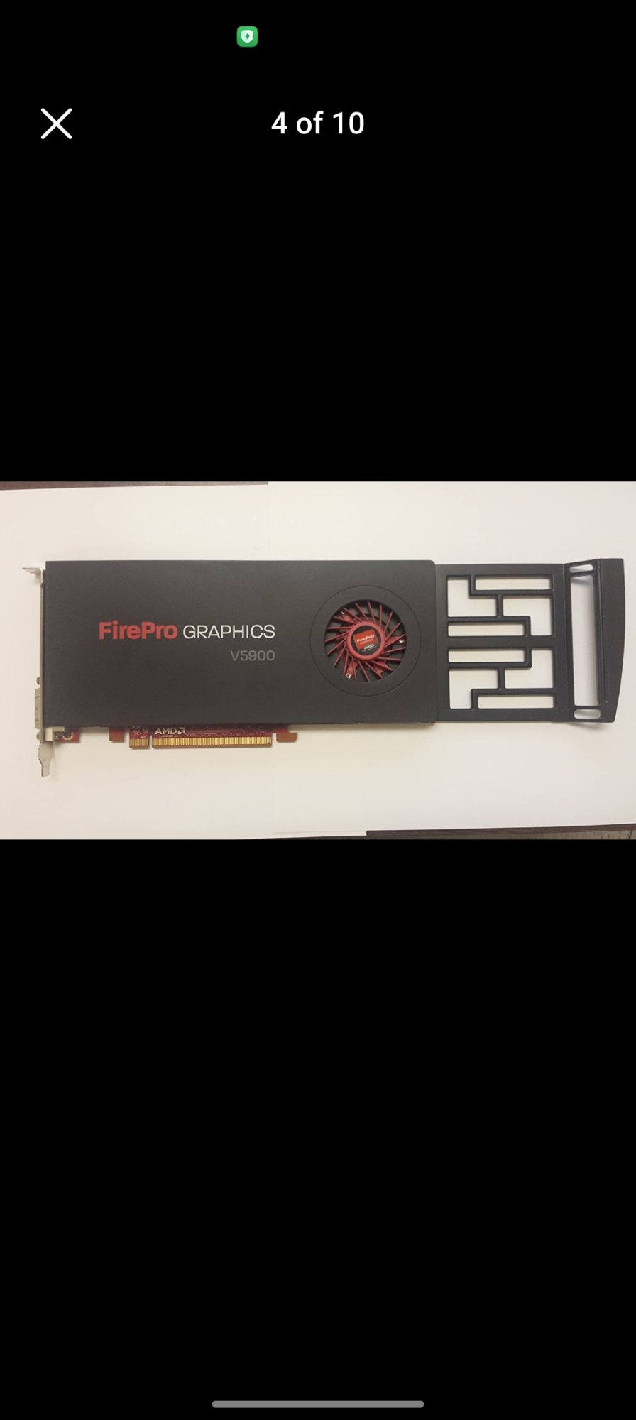

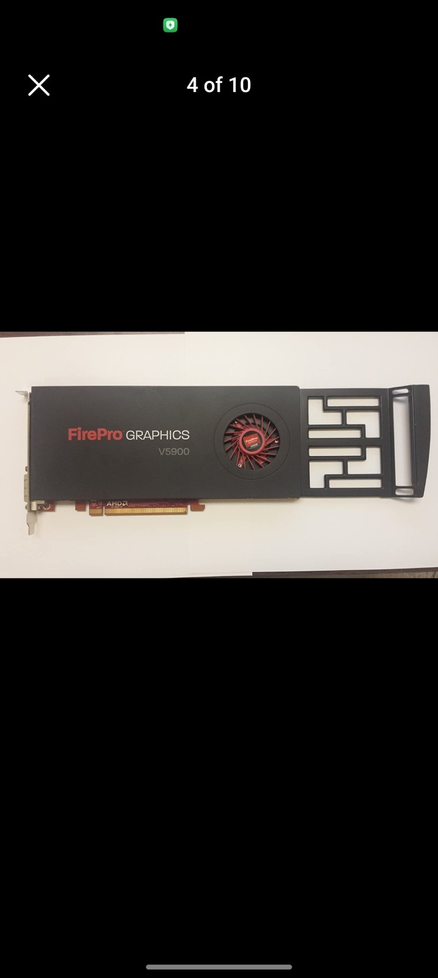

would this card let me see a boot screen? I know it's not the original card but I'm like 90% sure it's one of the original supported cards.

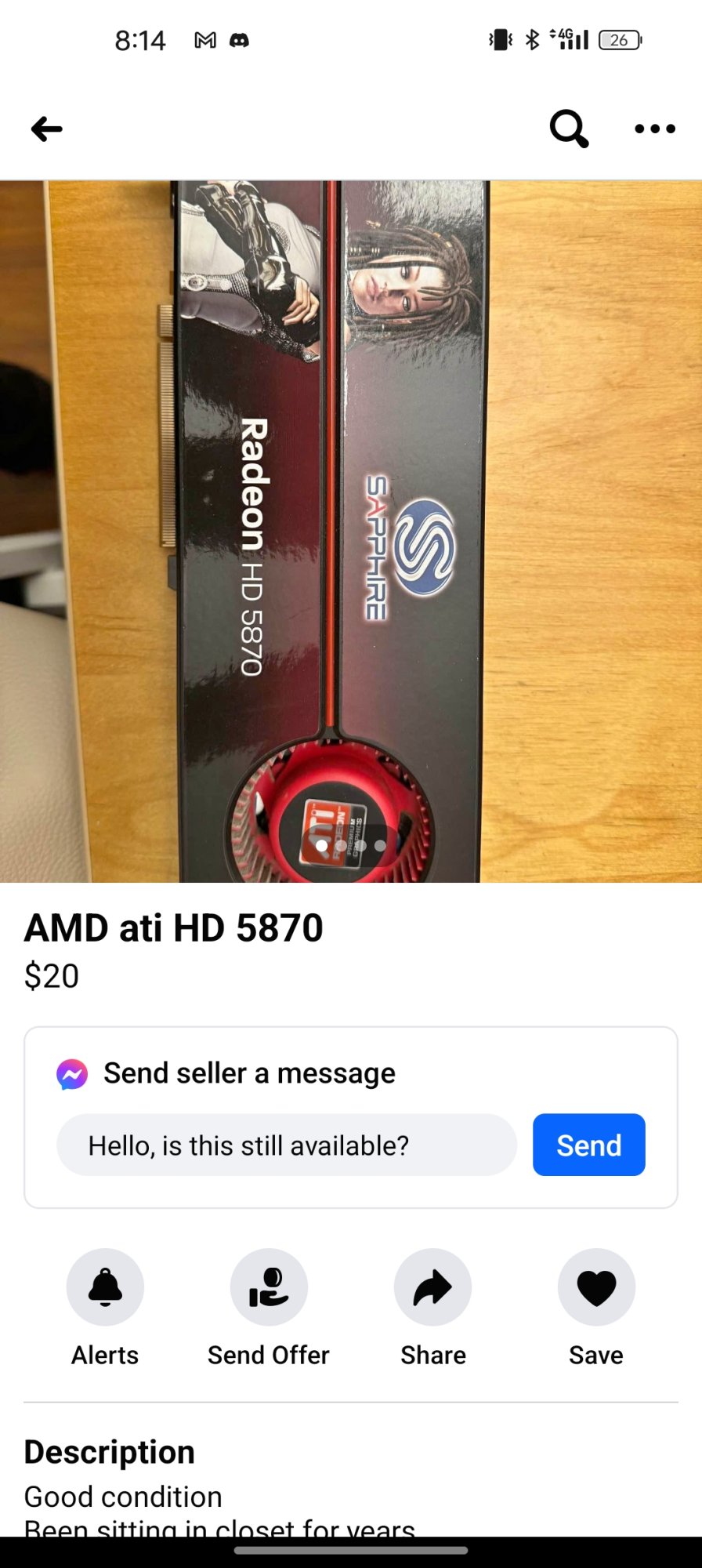

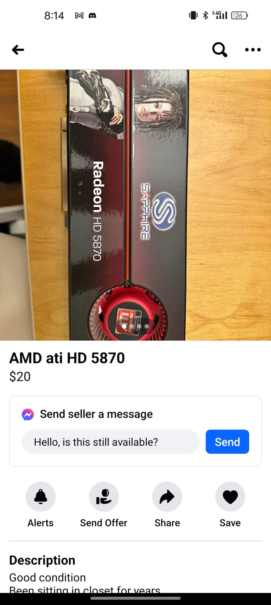

Interesting. I can easily find an ATI gd 5870 on Facebook marketplace. But does it have to be some "apple edition" or something or will this work?
Short answer, yes. AppleOEM means Apple made GPUs, with Apple part numbers.
Long answer, you can buy a PC GPU and flash it to be compatible with a Mac Pro, but it's not a simple task for someone that does not even have the Mac Pro working yet.
PC You need an AppleOEM GPU to make the Mac Pro working again easily. If you buy a PC GPU, you gonna need to flash it to have pre-boot configuration support and get your Mac Pro working again.
Btw, flashed GPUs fail while running Apple ASD/AHT diagnostic tools. So, you need a real AppleOEM GPU when doing diagnostics.
or something or will this work? View attachment 2360943
Nope. No pre-boot configuration with an un-flashed PC GPU.
