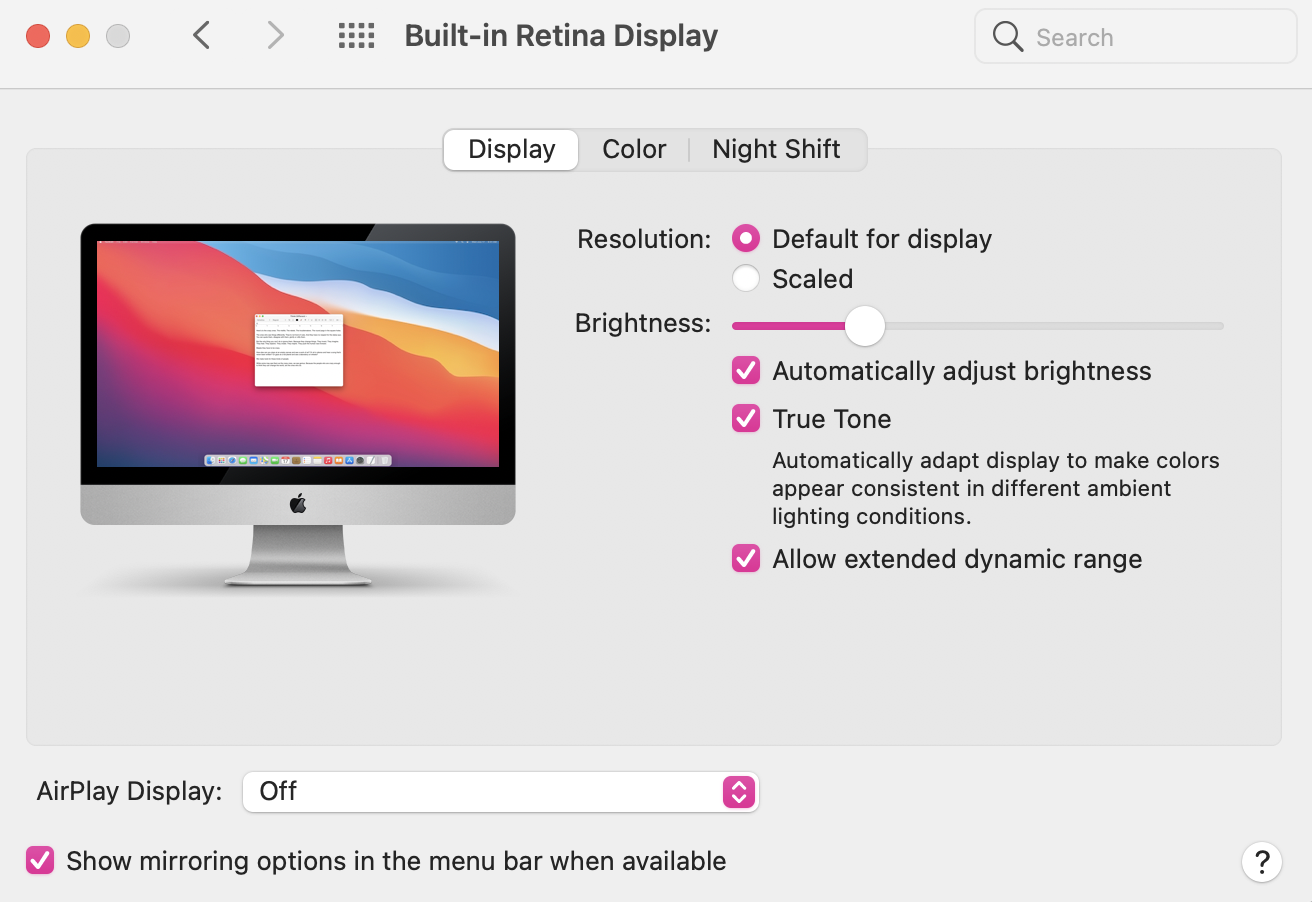

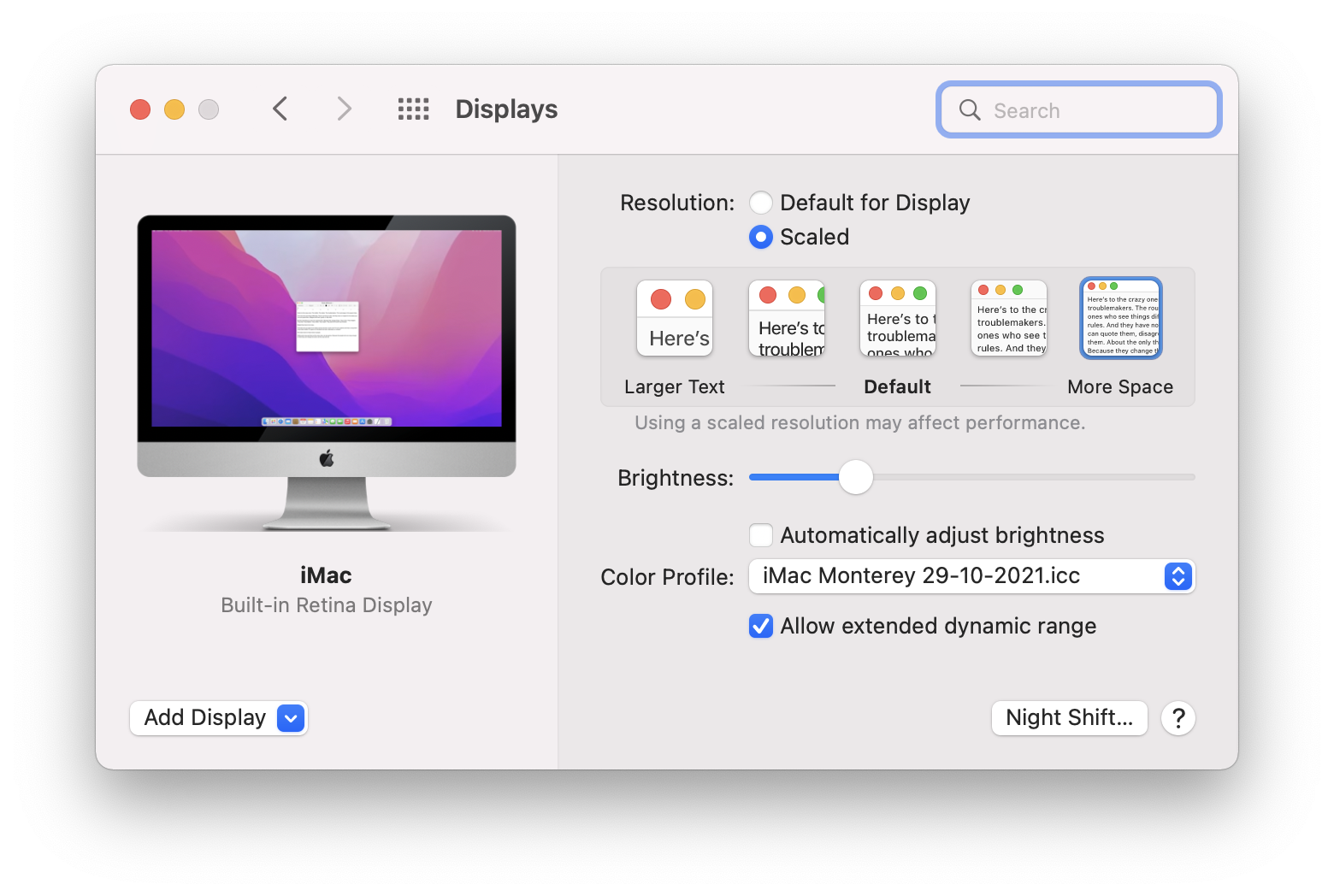

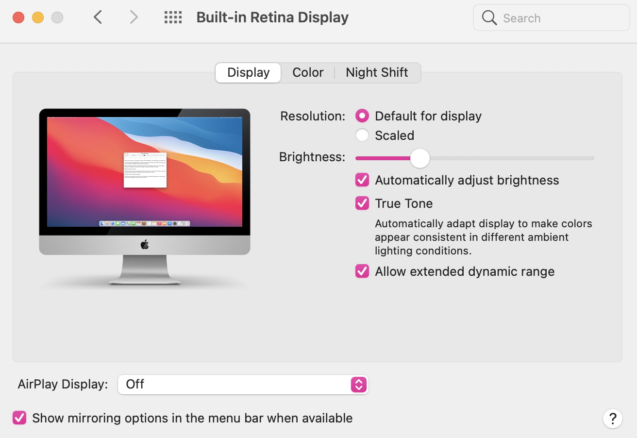

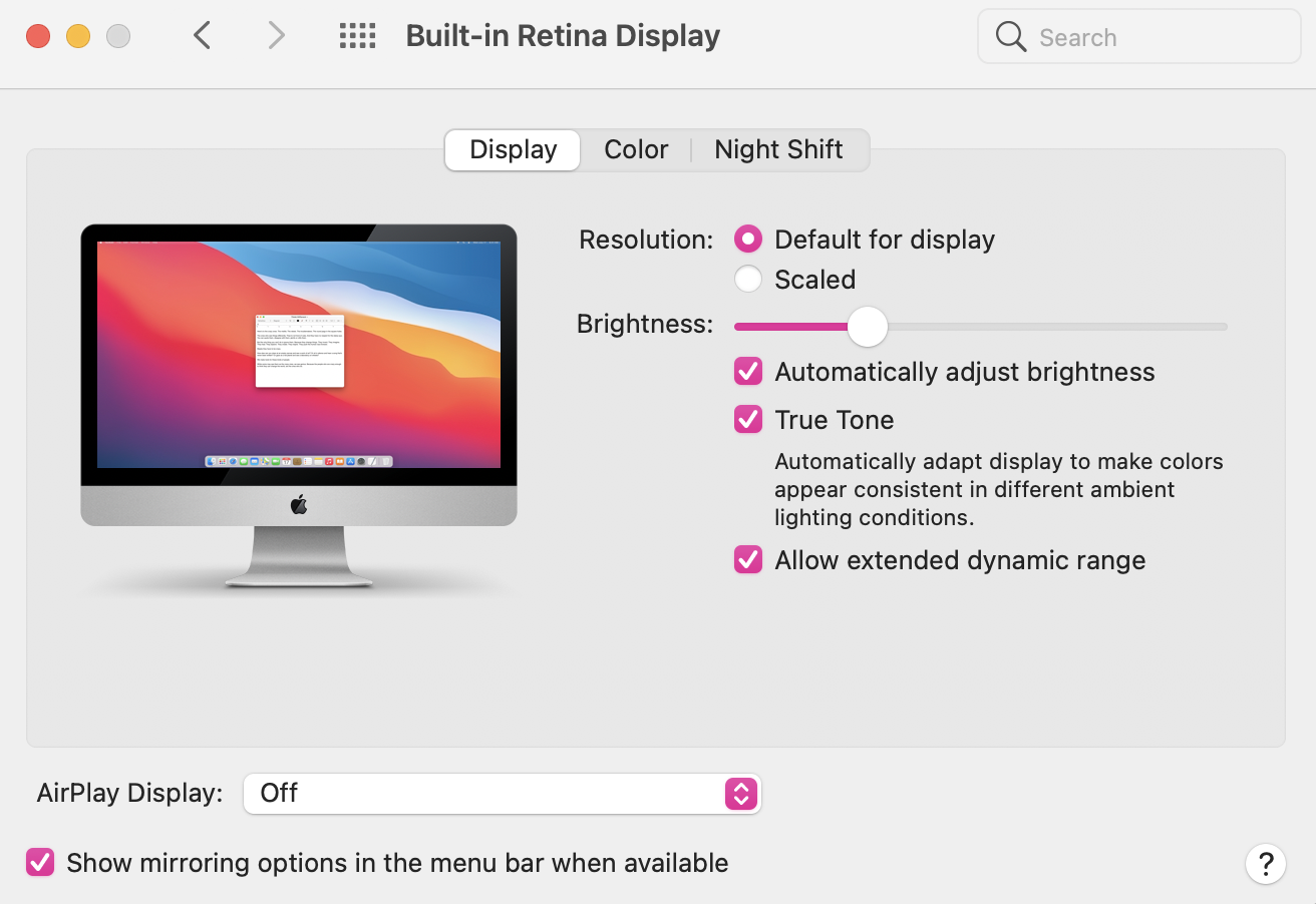

Hmm, I have not yet installed Monterey, but if you Option-click the Displays icon in System Preferences, do you still get the hidden choice for "allow extended dynamic range," and does that make any difference?
Big Sur:
Yes the option is still here but makes no differences to my eyes, probabily due to normal sRGB profile used by macOS during "normal" operation. Even in PS or Lightroom during a RAW development.
Reactions: drisley
