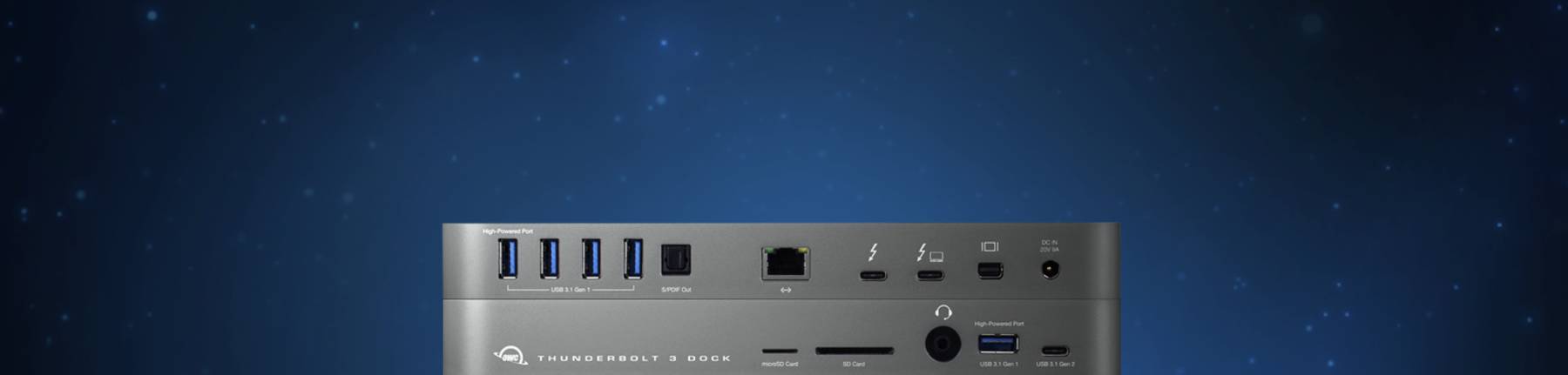

the OWC Thunderbolt Dock and Thunderbolt Hub (both are in pre-order status) offer extra 3 USB-C /TB3 ports plus the one you have to connect your laptop. The Dock is for a desktop setup where the hub is for more portable setups.
Both are fairly pricey options but there are the only available. if you're looking for hubs with more than 2 USB-C ports they should be on a TB3 otherwise it is not possible.
Currently, the USB-C architecture alone cannot support hubs with more than 2 USB-C ports that could pass data due to the bus design. So if you want to have more than 2 USB-C ports in a hub, this has to be a TB3 hub or dock.
